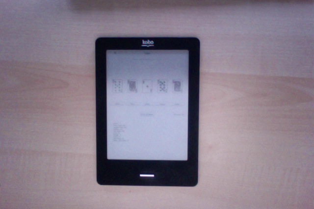

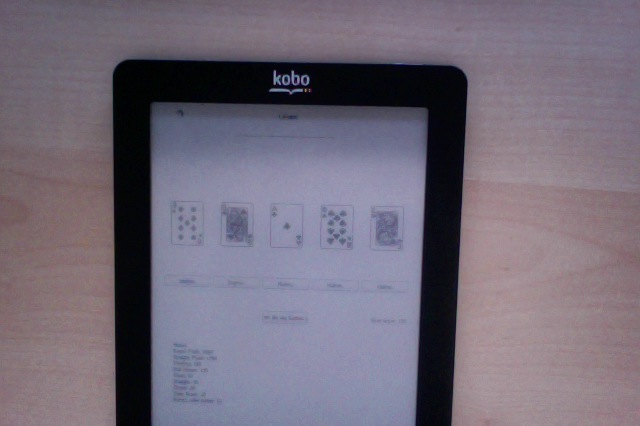

I noticed that, but luckily they are still close enough. After a bit of further debugging I got the poker example working (well, without any way to actually interact with it). It seems the plugin interface changed since March, any chance a newer version will get uploaded to github?
In the mean time, here is what I came up with. The old instructions are mostly correct, the only thing really missing was that I had to add --prefix= to the path in QT_EXTRA_ARGS and add -D QT_NO_QWS_CURSOR, in qt.sh.
The sources for the hacked examples are attached. PluginInterface.h was missing an extra argument (pointer to PluginStatus, but unfortunately the definition of that class is missing) and I had to change some minor other bits to get it to compile/run.
If anyone just wants to test it without installing the whole devenv, the compiled versions are in the archive as well. Just copy them to /usr/local/Kobo, open the KoboReader.sqlite database and duplicate some ebooks entry and change the mimetype to "application/x-games-videopoker". Then reboot the kobo, open the library and "read" that book. This should open either a largely blank page with a small "Hello Kobo Touch" or the poker game, depending on which library you copied. Input doesn't work yet, so there's not a lot more to do with it.
Please note that this is highly experimental and might cause your kobo to explode.

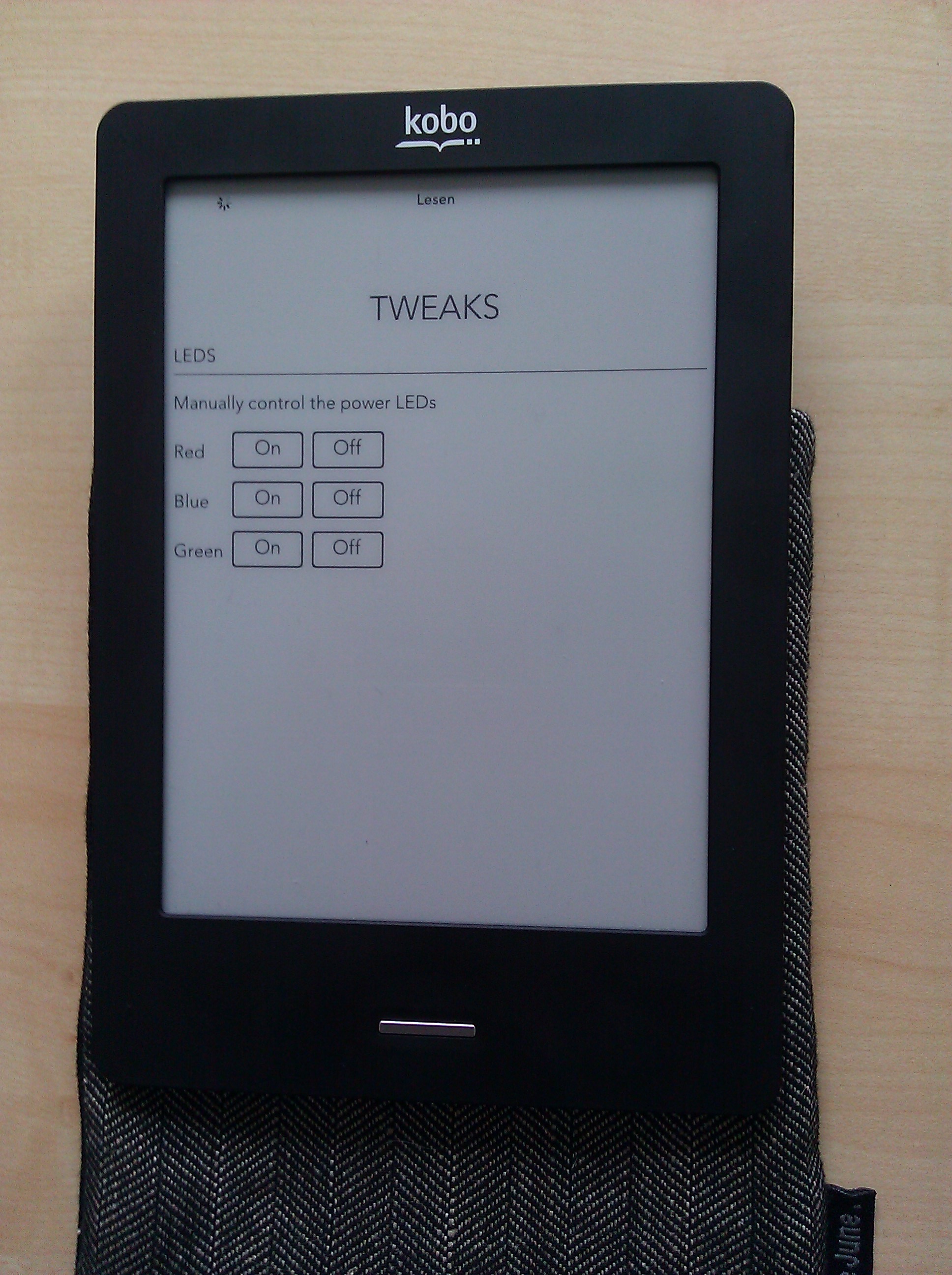

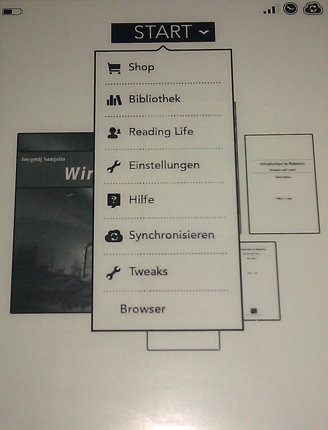

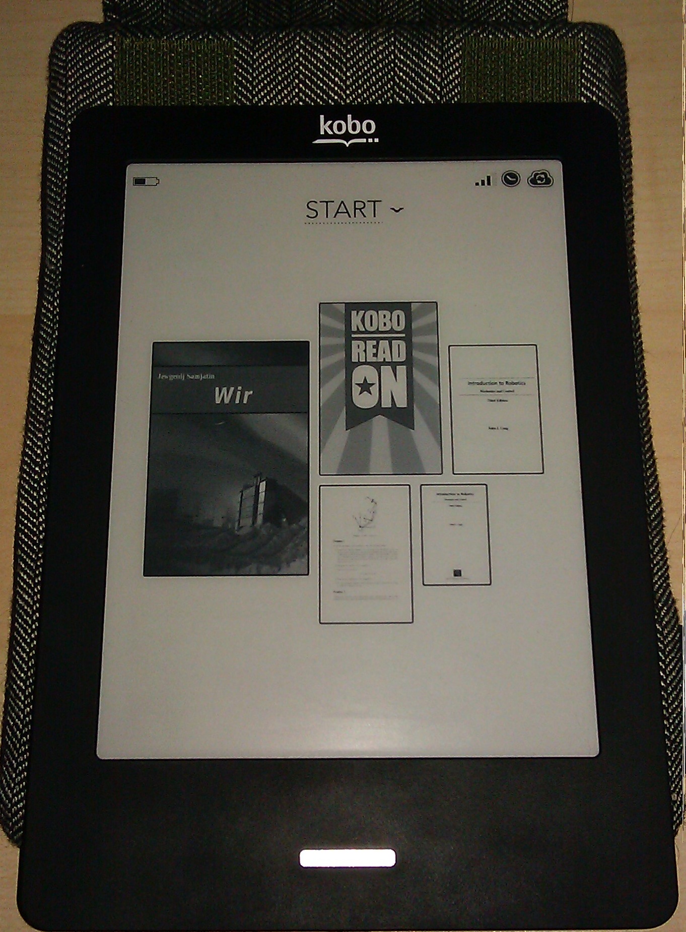

More news: I managed to get the basics to work and built a simple demo application. All it does at the moment is controlling the LEDs, but I'm planning to add more options like disabling the wifi timeout or hiding annoying UI elements.
As before, the source is at https://github.com/ah-/koboplugins and if you just want to try it, copy the attached library to /usr/local/Kobo. To activate it you have to open the library once, to deinstall it just delete libtweaks.so.

Would it be easy to add shortcuts to the menu this way like the "tweaks"-entry to existing Kobo-Features like the Browser?

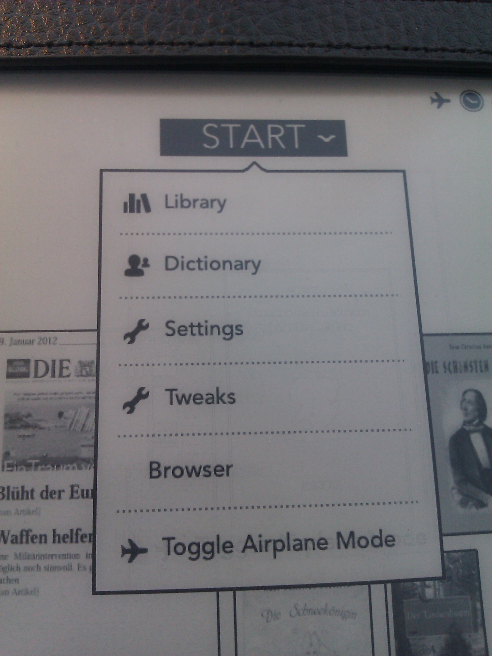

I've played a litte bit with 'ah-'s code and got the browser menu working.
In addition I've added a menu entry to toggle the airplane mode.
Attached is a 'KoboRoot.zip'. Just attach the reader to your PC and extract the file to the .kobo directory. Unplug the reader and it should install automatically.
As previously mentioned open the library once to start the plugin.

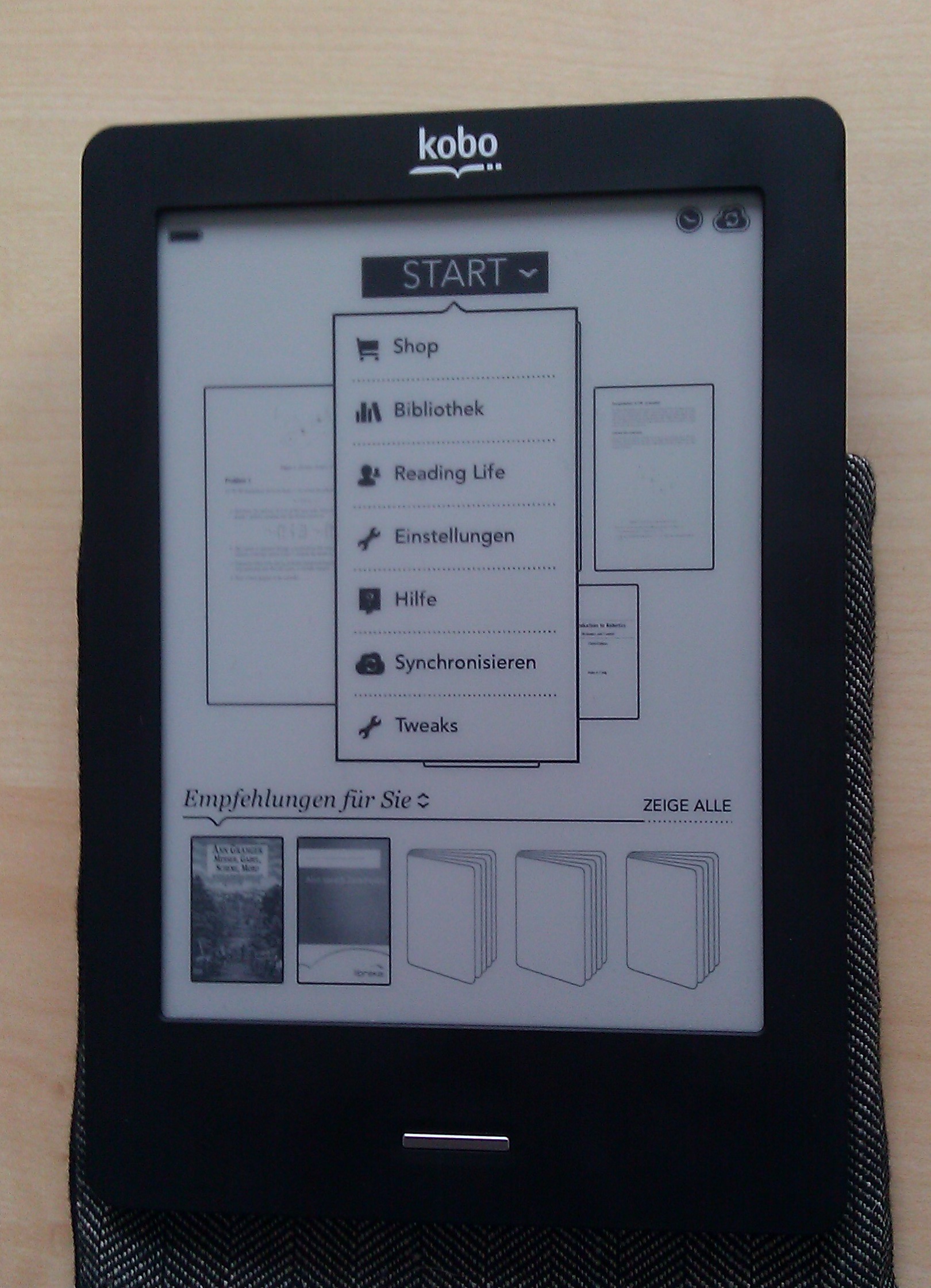

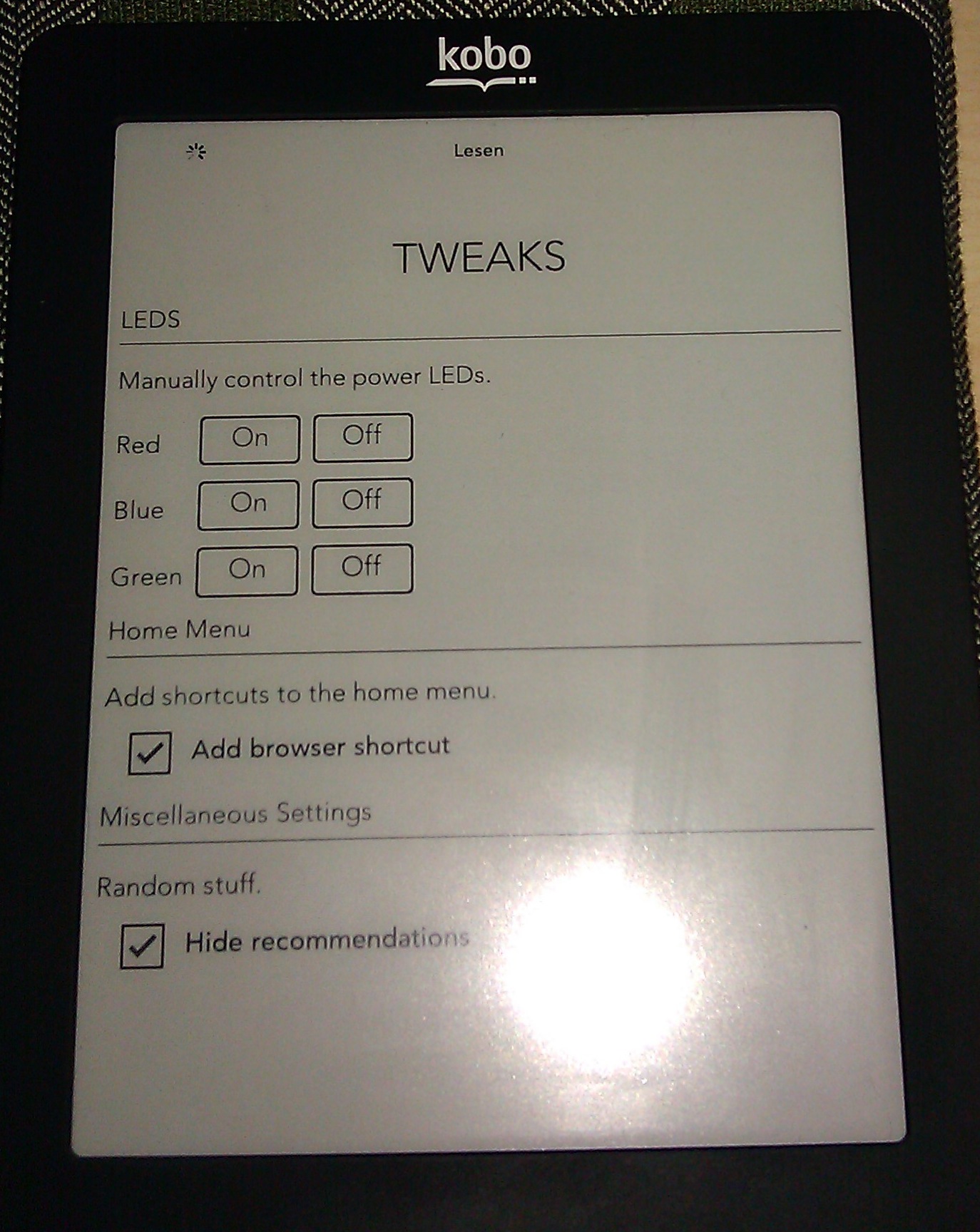

Haha, I just finished the new version with just that feature. It also supports hiding the recommendations from the home screen, since many people wanted this in the future firmware feature request thread.
If you have more ideas of what to add/alter please share them.
The installation procedure is the same as above.
@ah-: is there a chance that I could commit my changes to your git repo.
Of course! I don't have too much experience with github since until recently i just directly used git with my own server, but I guess the way to go is that you create a github account, fork the repository and then send merge requests for individual commits. Maybe we could also setup github so can directly commit to my repository, but I'm not sure how that is done.
Please feel free to improve everything.
Edit:
Oh, and before I forget it: I think we should come up with some simple deinstallation procedure if we start to distribute the plugin as easily installable zips. Just deleting it via ssh is easy, but not everyone has that set up. Maybe flashing some other file so the original gets overwritten, or some script that automatically deletes it. I don't want anyone to have problems because of the plugin if the Kobo firmware should ever update itself and change the interfaces.
Also checking the firmware version on load might be a good idea. And lastly, the qtscript plugin is potentially dangerous if you're not in a network you trust, since it's only intended for development and uses no authentication. Libtweaks.so works fine without it, so don't install the qtscript plugin if you don't know what it does.

That looks great Having seen the Home-Page without the Bottom-List my first impression is I would like some kind of small Buttonbar at the bottom of the page instead, rather adding custom-buttons for shortcuts there instead of adding them to the menu. I would at first think of having direct buttons for going to library, shortlist, browser and search...
Then, like for the browser in the menu or in a buttonbar, we would need icons...
If you tell me what the ideal format and proportion would be for additional icons, I could create some, maybe as a start for the browser in the menu as seen above and new one for the tweaks... For airplane-mode there is probably already one in the system that could be used
