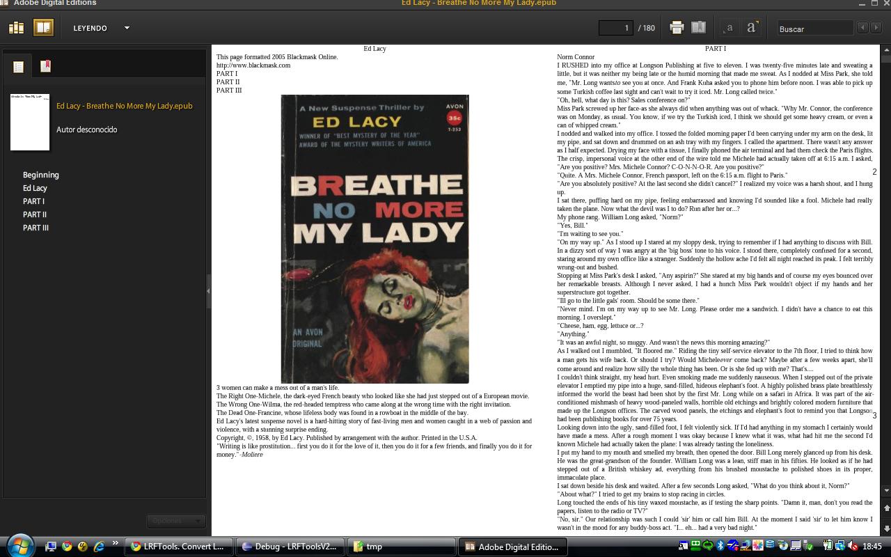

Originally Posted by RandallFlagg View Post
I tried out your fix and it was able to convert lrf to epub. I was able to add a cover via Calibre. Unfortunately all the text was pushed together, no idents or paragraphs. Also the fonts change size throughout the book and line spacing isn't consistant. Thanks and I'll try it again should you make any newer changes. Lastly, I just reconverted it again to make sure it wasn't Calibre when I converted back to lrf. It's not, the epub looks like this in Adobe DE.
Hi RandallFlagg,
I've performed some changes to lrf conversion as you can see:
I'm going to upload this new version right now.
elinares is offline   Reply With Quote
