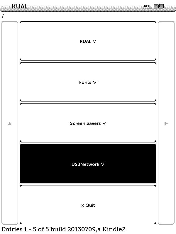

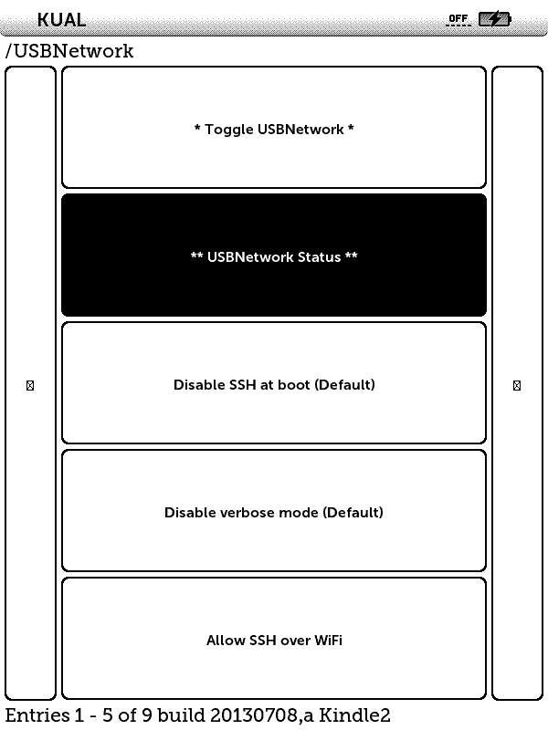

To answer knc1
(Don't mind the broken up/right arrows, that's due to the crappy unicode coverage of my custom Sans font)
Old 07-09-2013, 09:06 AM   #909
knc1
Going Viral
knc1's Avatar
Posts: 17,212
Karma: 18210809
Location: Central Texas
Device: No K1, PW2, KV, KOA
To answer knc1
Thanks!
Looks very usable to me.
(At least the pic doesn't say: "SegFault" anywhere. )
That earns the K2 a: "K2: status" field in the (to be) new button blob template.

That did lead me to wonder: do the arrows work on a DX? Because I use the exact same font on my K3, and the arrows work there, but then FW 3.x has a much larger Unicode coverage through the code2000 font (or droidfallback in my case).
I'll try with the default fonts to make sure...
EDIT: Well, crap. No shiny arrows with the default fonts, either. I'll fire up fontforge...
EDIT²: x-ref: https://bitbucket.org/ixtab/kindlela...-graphic-on-k2
EDIT^3: One very dirty workaround later...
ID:	107933   Click image for larger version
