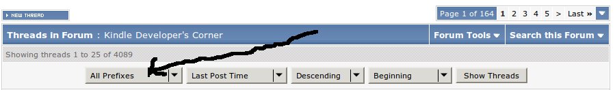

A B094 is known here as a: PW2
Ref: https://wiki.mobileread.com/wiki/Kindle_Serial_Numbers
Now, while logged-in and looking at the forum's first page of its index -
Just below the blue bar, find a drop down box: "All Prefixs" -
Set that to 'tools' -
Click 'Show Threads'.
There you will see NiLuJe's snapshot thread (where you can find the most recent build of the common add-ins.
In the second section - title includes 'PW2' -
You will need both Python and the ss hack packages -
Unarchive both -
Read directions of both -
Use MrPI to install (you can put both *.bin files in /mrpackages at same tine).
Installing a package also installs any KUAL menu entries.
Read directions in first post about using the uninstall packages, at:
https://www.mobileread.com/forums/sh...d.php?t=195474

No, I do not mean the advanced search, I mean the prefix filter on this forum's index pages.
See attachment for a hint on where to look.
