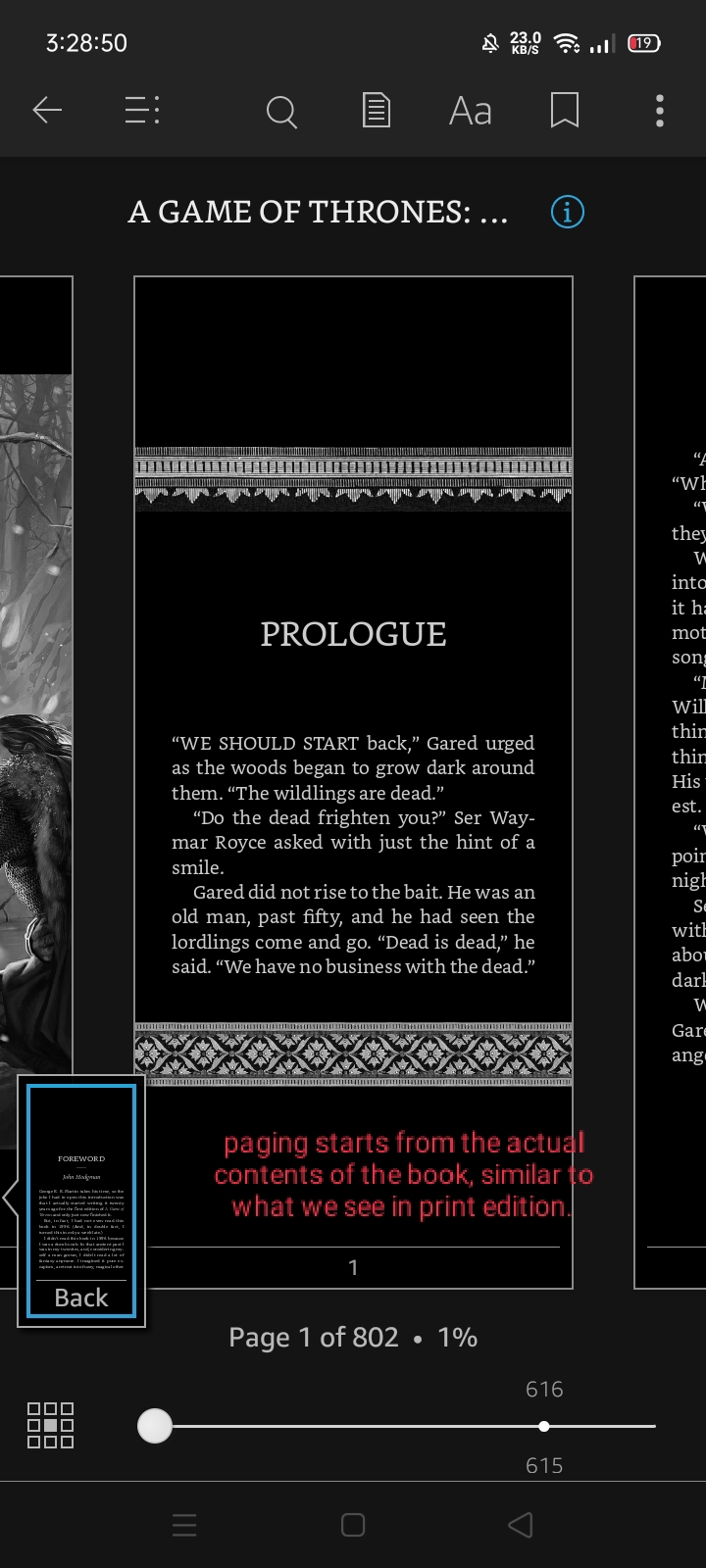

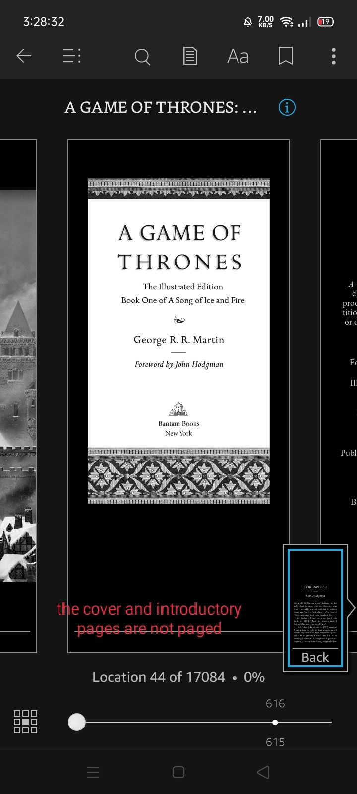

Hi, thanks for the reply. I think i'm gonna buy the kindle fire. In the meantime, im using my phone to read the kfx files. However, I noticed that when page number is added while converted from epub to kfx, the 1st page starts from the cover. But it's not the same in amazon books. Usually the page number starts from the actual text of the book rather than the cover and introductory page. The cover and introductory pages aren't usually paged. I noticed this in a book i borrowed from my library.
This plugin takes a simple approach to numbering pages. It numbers everything in the book starting from page 1 up to the total number of pages. This makes the last page number match the total number of pages and causes page numbers to change at reasonable intervals when reading. It is not intended to the match page numbering found in published books.
If the locations of page numbers are specified in the source file being converted they will be retained in the KFX file produced. That leaves open the possibility of using other software to define the pages the way that you want them to be.
So this plugin averages the number of the page that is given in the custom column, correct? If this is the case, Can you make it so the averaging process start from a certain point and ends in another?
I'm sorry if I'm being an idiot, I'm new to this all calibre thing.
The plugin obtains the desired number of pages either from a custom column or it infers a reasonable value from the size of the book.
It then divides the content of the book into that number of pages by adding page markers throughout the book so that each page contains close to the same amount of text.
It is technically possible. The main issue is determining at what points to start and stop.
If selected by the user then a method would have to be implemented to communicate those points to the plugin. I doubt that it would be used much due to the manual effort involved for each book.
If determined automatically then criteria for selection of those points would need to be established. It would take research to do that and whatever was developed would likely fail for some subset of books.
So while it would be possible to change the plugin to do this, it would take more time and effort than I am willing to put in just to make the page numbering better resemble a print book.
