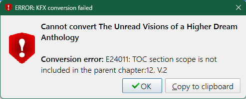

Old 07-28-2024, 09:14 PM   #1516
jhowell
jhowell's Avatar
Posts: 7,119
Karma: 92500001
Location: Charlottesville, VA
Device: Kindles
Originally Posted by Elaine T View Post
Occasionally, the Tables of Contents get screwed up. Mostly I sigh and put up with it, because the document isn't very long. Today I updated a book that had seventeen chapters, converted to KFX and put it on my paperwhite. The ToC showed chapters 3 and 9. The log from the calibre job doesn't show a problem at least not as far as I can tell - pasted below at the end of this post.
Yes, the log does not show anying significant.
ANy ideas on what and where to tweak to stop it?
My only suggestion is to PM me a link to someplace that I can download the original file that you are converting to KFX so that I can convert it to KFX myself and see what might be going wrong.
I don't seem able to edit the kfx files in calibre to fix the ToC that way, either. Unless I've missed something, which is always possible.
There is no way to edit KFX format.
Old 07-29-2024, 05:56 PM   #1517
tomsem
Posts: 6,959
Karma: 27060153
Join Date: Apr 2009
I have searched for other reports of this, but haven't found any. So... I use Calibre & fanfiction downloader a lot to get fanfictions and other stuff onto my kindle (paperwhite, if it matters). And the KFX Output plugin to get them into the proper format for my kindle.
I could just go back to using an AZW3 for this one - it works, I tried it. But I'd really rather have KFX, as that format does behave better on my device. ANy ideas on what and where to tweak to stop it? I don't seem able to edit the kfx files in calibre to fix the ToC that way, either. Unless I've missed something, which is always possible.
Note: a couple hours ago I check the problem file in kindle previewer and it displayed, as it does on my device, with just the two chapters showing. I closed and deleted the kfx file. I just tried converting the epub to KFX again, it, to get a screenshot, and this time the previewer complained that the file extension was incorrect. It's .kfx. I haven't done anything that should have caused that - I left the computer alone before coming back to post this plea for help. So, what may be going on there?
Suggestions for either problem are welcome! Thanks
I would open the ePub with calibre Edit and check for problems. You can also see what the ToC looks like there and edit it as needed, before conversion.
Old 07-29-2024, 07:26 PM   #1518
jhowell
jhowell's Avatar
Posts: 7,119
Karma: 92500001
Device: Kindles
That is a good point. I assumed that the table of contents was verified as being correct in the source file before conversion.
The conversion process is very picky about the table of contents entries being in the same order as the contents of the book.
You can add the TOC tool to the Menubar. This appears to be the same as in the editor, just that is all it does.
I was supposed to be subscribed to this thread so I'd see any replies quickly. I didn't get any notifications.
THanks to jhowell and tomsen for your help. The book was fine in epub. I've tweaked the ToC in the epub (flattened it), and tried converting again and got a brand new error! Screenshot attached.
This is well beyond my knowledge of how to handle. As it is, for now I'm falling back on AZW3 so I can read the thing, but if anyone has insight on how to fix this latest for the next time I see it, I'd appreciate it.
(resubscribing to thread...)
Name:	Calibre kfx conversion error.png
Elaine T is offline   Reply With Quote
Amazon's Kindle Previewer performs most of the work in converting from EPUB to KFX. That software is very picky about the table of contents. The order of entries in the TOC must match the order of content within the book and the nesting of entries is significant.
It appears that in tweaking the TOC you inadvertently broke one of Amazon's rules leading to the book being rejected.
