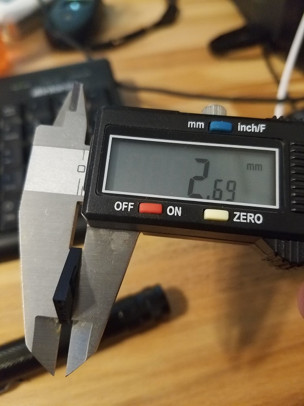

Anything bigger than 2.6mm will likely cause issues with the back plate sliding back on. A IDT connector (sometimes called Dupont?) without any guides/locking clips SHOULD be ~2.55mm thick

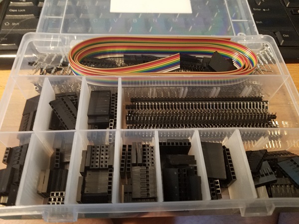

you talking about this kit, lol? Click image for larger version
This is the one I bought just for the header pins in it, because I like to be prepared with spare parts.
I get an actual measurement of 2.69 mm on my digital calipers on two pieces I tested.

Probably lol. Was that the $15 one at Micro Center?
If so, can you tell me if those stupid cables are solid or stranded, and roughly what gauge they are?
Aroth is offline   Reply With Quote
it looks to be stranded, I dont know much about guage, but.. small. Im guessing about .3mm of strands, that puts it around 28 guage? that just eyballing it, the plastic sheathing is 1 mm total. I took a third of that for the core.
coplate is offline   Reply With Quote
