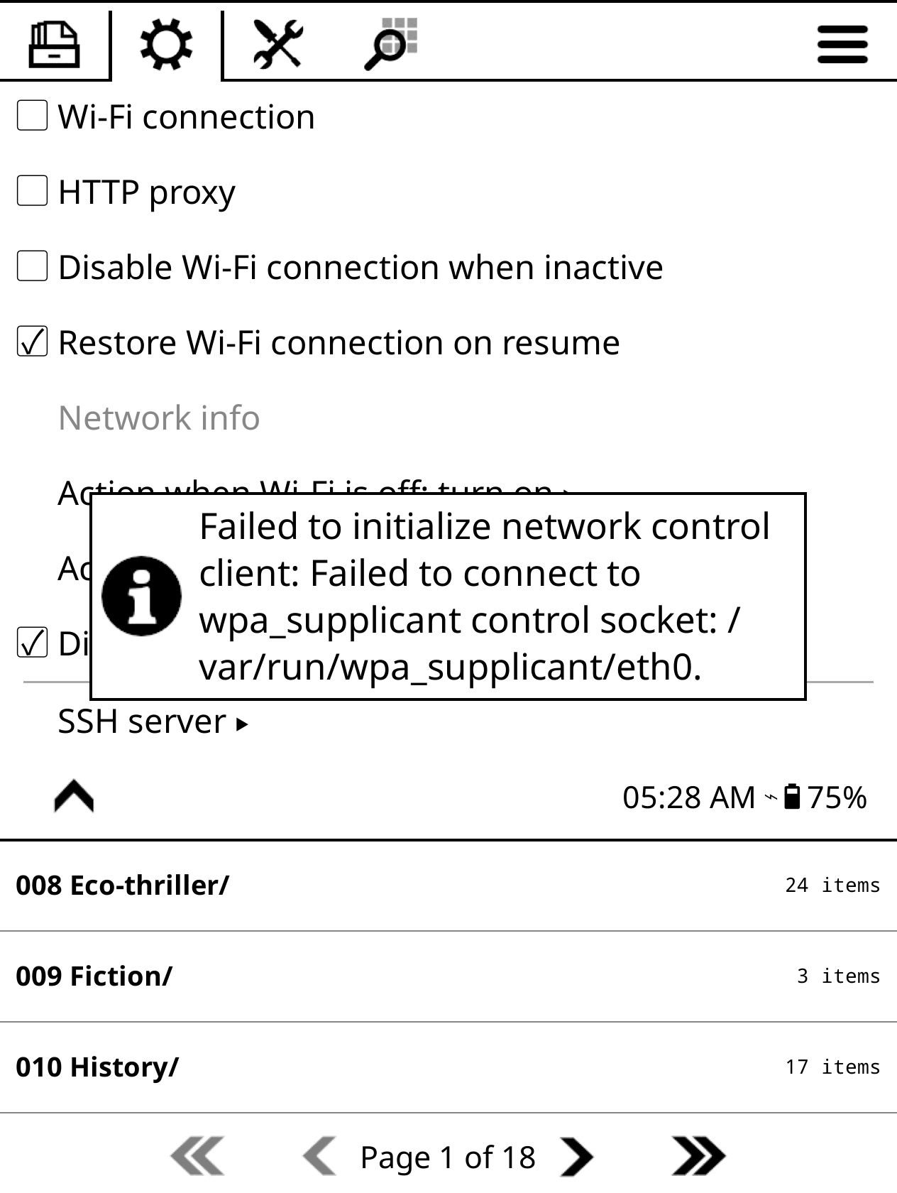

My Kobo Libra H2O automatically updated to FW 4.23.15505 (6da428b202, 8/10/20) yesterday. Automatic sync was not checked, but the FW updated anyway.
I reinstalled the One-Click Install Package for KOReader (OCP-KOReader-v2020.08.zip from the first post in this thread). I used the script with Powershell.
All went well, however, I now cannot connect Wi-Fi connection in KOReader.
I have "Restore Wi-Fi connection on resume" checked.
I also have "Action when Wi-Fi is off: turn on" selected.
"Wi-Fi connection" does not have a checkmark, so when I select it shows "Scanning for networks" then this message immediately pops up:
"Failed to initialize network control client: Failed to connect to wpa_supplicant control socket: /var/run/wpa_supplicant/eth0."
Wi-Fi is enabled in Kobo reader.
When I reboot the device and through NickelMenu select KOReader, KOReader opens, Wi-Fi connection IS checked. However, when I close my cover to put the reader to sleep, then open it again to wake up, the W-Fi connection is no longer checked. Then when I select it again, the above Failed to initialize network control client message appears.
Same behavior when I "Restart KOReader".
I use the calibre wireless connection to send my books to the Libra. And I use Progress sync with my Libra and my phone.
Please let me know if I can provide any more information. I really appreciate your help! Thank you.

We'll release a 2020.08.1 in a few days to deal with that, but in the meantime you could update to the current development version. Either on the device itself (change the channel from stable to development) or by downloading it from http://build.koreader.rocks/download/nightly/

Thank you so much for your help @Frenzie! I installed the version you suggested and it seems to be working correctly now.
