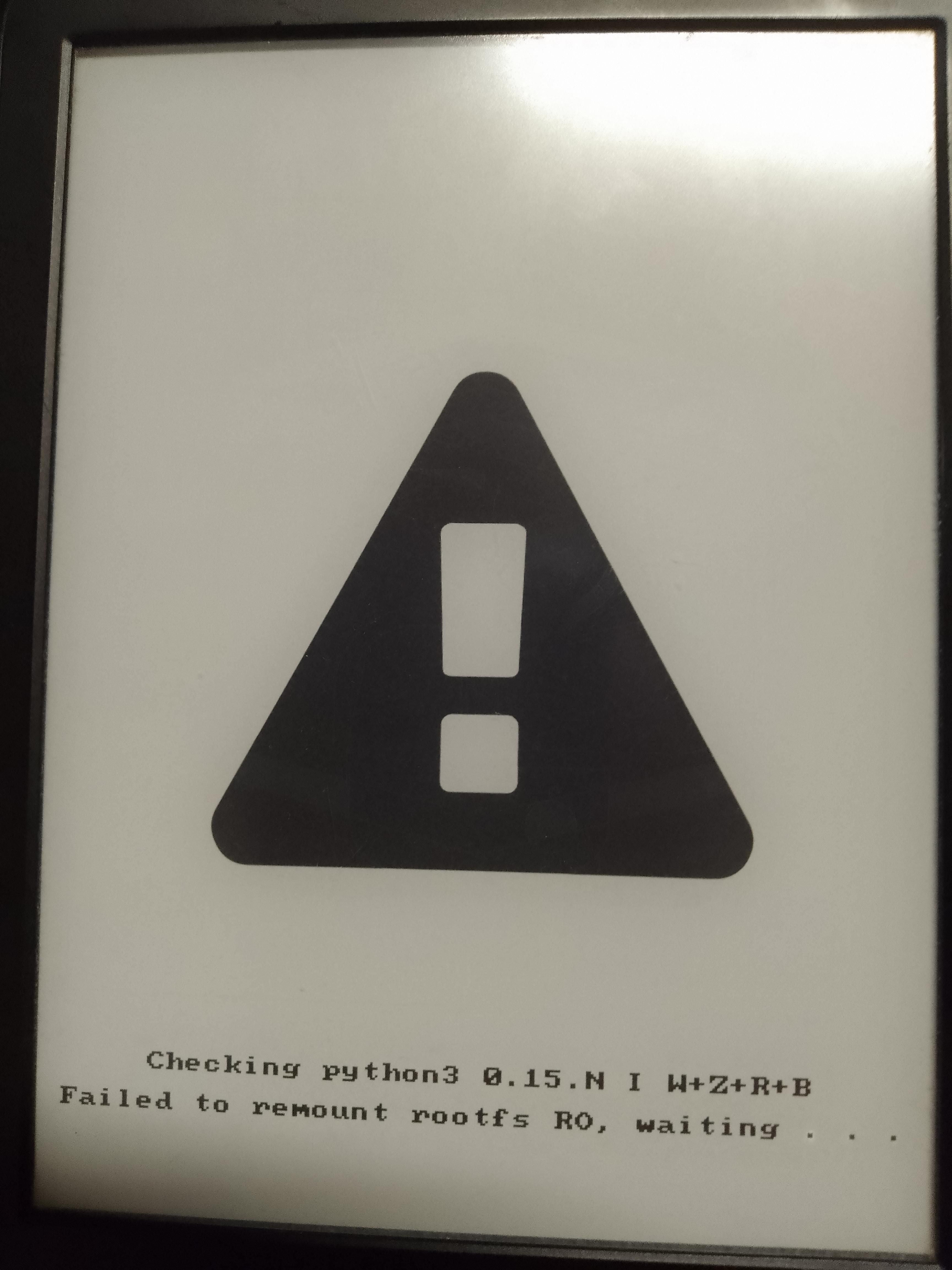

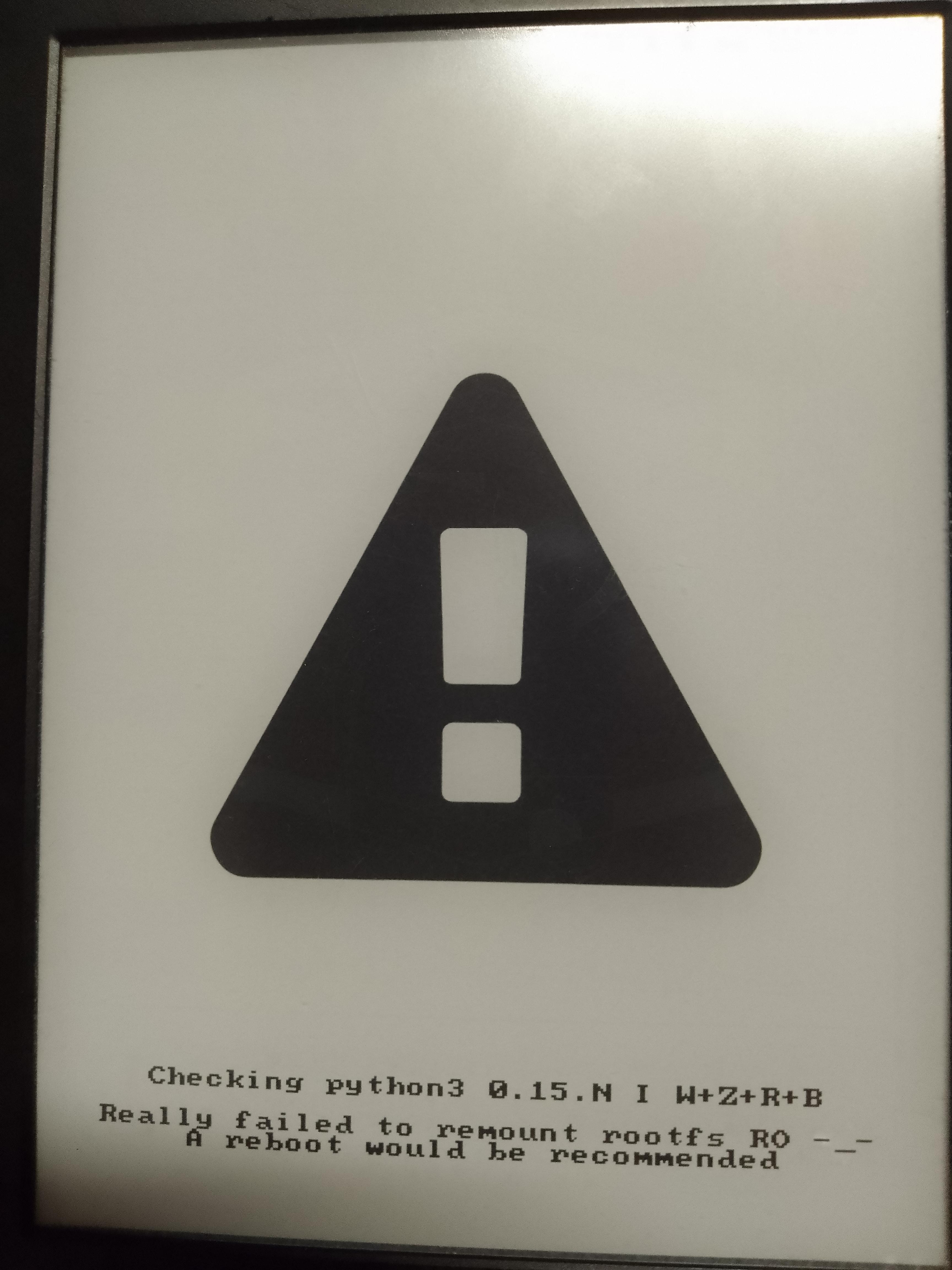

However, I installed MRPI for HF but still get errors when installing packages, for example Python.
The message I get is:
Really failed to remount rootfs RO
Am I doing something wrong?

There have been several messages about attempting to install Python 2 or Python 3 and the responses have indicated that the current Python packages are not compatible.
Thanks for your answer.
So I gather that the error is not with MRPI but the Python package itself.
Will keep an eye on that.
