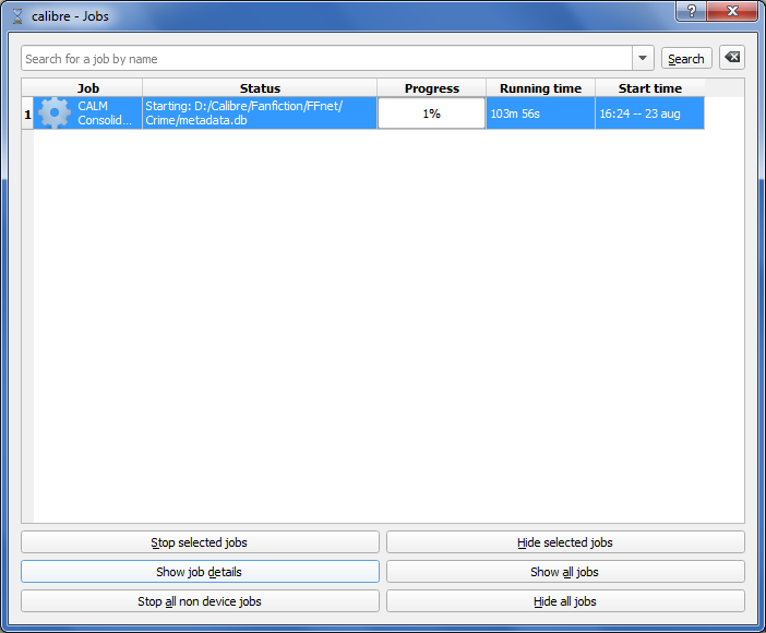

It has been running in 105 minutes and is still only "starting".
Starting job: CALM Consolidation
Starting CALM Consolidation
CALM DB: D:/Calibre/Fanfiction/CALM/metadata.db
Tue Aug 23 16:24:14 2016
Python: Windows   CPython   2.7.9
SQLite Version: 3.8.4    [APSW]
PRAGMA main.locking_mode = EXCLUSIVE;
Beginning 'Consolidate All Library Metadata'
Attaching to New Source Library: D:/Calibre/Fanfiction/FFnet/Crime/metadata.db
Consolidating Source Standard Metadata: Tue Aug 23 16:24:14 2016
Name:	Skærmbillede 2016-08-23 18.08.12.png
Old 08-23-2016, 01:14 PM   #158
DaltonST
Deviser
DaltonST's Avatar
Posts: 2,265
Karma: 2090983
Join Date: Aug 2013
Location: Texas
The Job Log says it is still working on copying the standard metadata (not the custom column metadata) from the very first library.
As I said, ignore the percentage complete since that is based on the number of libraries you are consolidating.
Read my previous post about how long CALM will take compared to doing with Calibre.
105 minutes so far would be very, very reasonable for 50,000 books.
DaltonST
