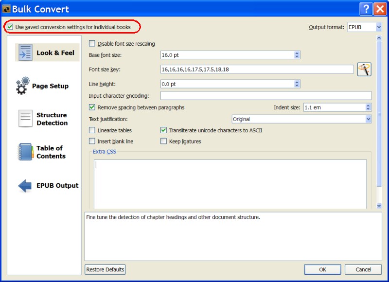

If you go to do a bulk convert it will use the same settings for the conversion this time that it used the previous time unless you uncheck the top left box (see attached) Use saved conversion settings for individual books. If the box is unchecked it will use whatever settings you give it in the bulk convert window.
