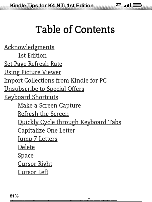

I can tell you that my K3 and my K4 NT both support multi-level TOCs. As @susan_cassidy states it does require the publisher to format the TOC/book correctly, and we all know that most eBook publishers have great difficulty getting their eBooks formatted correctly.

Thanks for your responses, but it looks like from the picture you posted that we mean different things by multi-level. I don't mean merely indented, but linkable/clickable. Say there's a long academic book or a Bible with thousands of chapter or sub-chapter headings. In the Kindle, will the contents display all of them at once, so that to get to the last entry, one must first page through many entries? Or could it be done like in the Sony Reader, where one might click (say, for the Bible) first New Testament, then Revelation, then chapter 20--all within the Kindle's contents menu? Otherwise it would be cumbersome to get there.

The example I gave is linkable/clickable as you say. I used H1 HTML tags to designate level 1 headings and H2 HTML tags to designate level 2 headings. Each is automatically incorporated into the TOC and thus linkable. However, the Sony scheme of expanding or contracting heading levels within the TOC is not supported by Kindle. I wish it was!
BTW, a huge TOC like that for a Bible is never going to be good on an eReader, even when using a Sony. There are just too many headings in too many levels. A new scheme must be discovered to quickly navigate a Bible type of document. I believe @Sirmaru (sp?) developed one for the Bibles he formats. You might search here for that scheme. It was a year or more ago that i saw his post, so it might take some digging to find it.

Kindle does not support multi-level TOC in the ePub sense. A Kindle TOC is just another page in the book with hyperlinks to chapters/sections. Those hyperlinks can have an outline structure, i.e be 'multilevel' in appearance. But to use it, your reading position actually changes to the page with the TOC.
An ePub TOC is based on an NCX structure that is a separate component within the ebook, and the reading system can bring up a navigable TOC view, sometimes being able to 'collapse' the multi-level view. And you can dismiss the view without leaving your current position in the book. It is usually quite a bit nicer than what Kindle offers, but occasionally you find reading systems that only show the top level of the TOC (like Nook Touch). Probably that's what the OT is asking about.
Kindle ebooks often also contain an NCX, but it's only used for chapter navigation, and functionally it is really only top-level (though you can coerce it to navigating 2nd level also). The Kindle Previewer actually has an 'NCX view' that is very much the same as an ePub reading system. Wish they would add that to Kindle itself.
