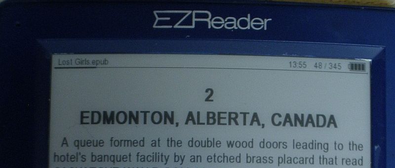

I really can not understand how you are getting the rendering that you describe with the Lbook firmware from 22 June 2010??? Here is a small screen sample of a book that I recently purchased and converted to EPUB. It shows the beginning of a new chapter with the usual centering, font enlargement, and bolding for titles and subtitles. New chapters always start on a new page in all my EPUB books. This screen sample is running on a 5" PockePRO with the 22 June 2010 Lbook firmware and CoolReader instead of ADE.
Originally Posted by tmclough View Post
I know that I could manually edit each .css file, to make them work the way I want them to under LBook's CoolReader, but then what will happen when there's an upgrade, or Astak has an upgrade, or OpenInkpot works for the Pocket Pro/V5, etc., and I have to edit everything again, and again, and again....
There is certainly no need to do that. I never custom tweak the CSS that I use in the EPUB files that I build. They all use the same CSS.
I am wondering if you actually downloaded and installed the correct 22 June 2010 Lbook firmware, since the situation you seem to be in is something that I seem to remember from last year?????????????????????????????
