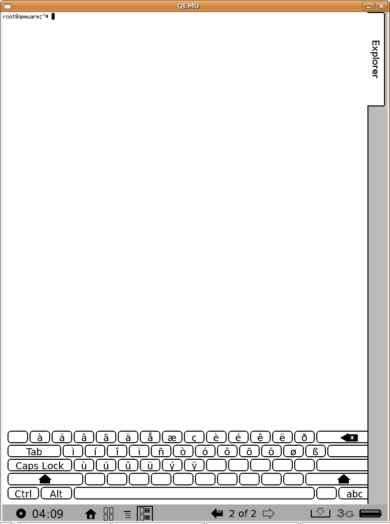

Check it.
Third layout not accessible. I can switch only 2 layouts.
yuri_b is offline   Reply With Quote

Originally Posted by yuri_b View Post
Check it.
Did you install the correct layout (I see that you installed the new library)?

OK
It seems to work.
A bit big for DR800
Thanks
A bit big for DR800
But you can now make your own ...
(Start with default_keymap.xml)
Mackx is offline   Reply With Quote
