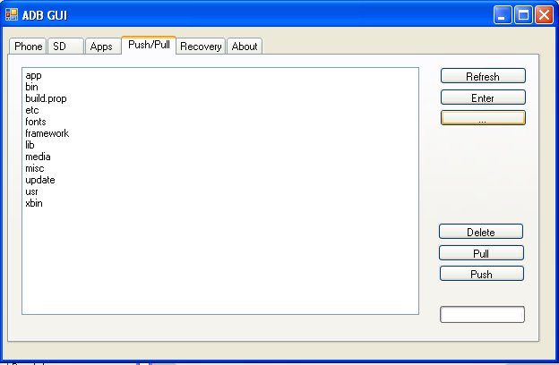

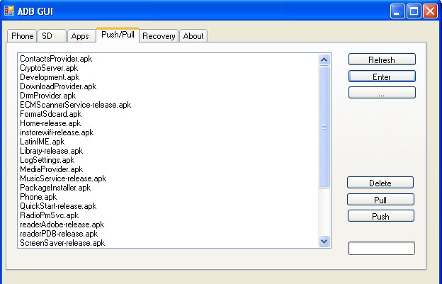

Found this interesting freeware here:
http://forum.xda-developers.com/show....php?p=4869749
I need to use wifi to connect my Nook with normal command line first (adb connect...) before I run this software. It will then auto detect my Nook.
I can browse several system folders, can push/pull, delete files by using this gui, , install application, and many more.

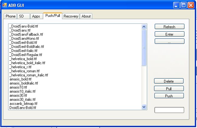

I try to find where Nook keeps its fonts for content display (Helvetica Neue, etc) to no avail!
Exploring how this could help me do things easier because I'm not a techie guy.

Great link bthoven. Addressing your question: http://nookdevs.com/Font_Changes

Hi stangri,
thanks. I've replaced stock Droid fonts with other Droid which support Thai for browser and feed. I also replaced helvetica fonts with Thai fonts; but this only change some interface fonts. I've tried that Asian CDs, it doesn't display Thai content in my epub books.
I try to find helvetica neue fonts inside Nook so that I can replace it with thai font.

bthoven, you do know that the epub reader has its own fonts and that you can manipulate with the epub stylesheet file to use other fonts, right? It's sections 5 & 6 at that wiki page I think.
Thanks. I know about it and had tried it before (with DroidSansFallback.ttf). Unfortunately, it won't work with enews I fetch by Calibre (or I did something wrong??).
