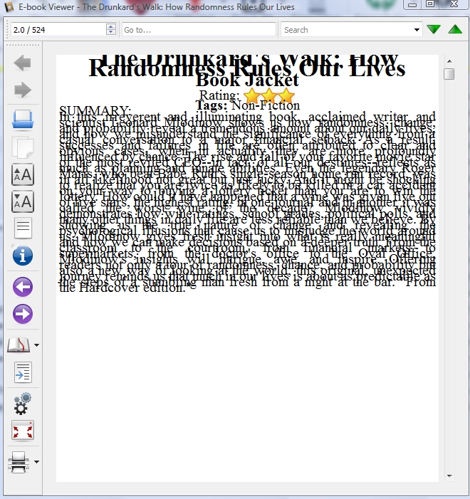

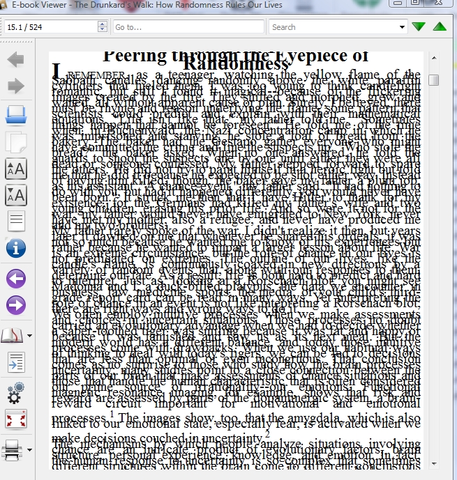

Converted my entire ebook collection to EPUB and ended up with books that have overlapping text. I have tried changing the font sizes and line spacing but nothing seems to fix it. Please help. ![]() Attached - actual EPUB file and 2 screen shots |

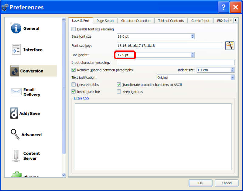

Usually I have Line Height set to 0.0pt but when I run into this I just make sure the Line Height is set 1.5pt higher then my base font. See attached.

That fixed the title and chapter section but the actual text of the book is still overlapping. Any other suggestions? Settings tweaks?

I had a look at your book and it is a real mess. I deleted all the line-height lines in the CSS and that fixed the problem of the lines running into each other. But the formatting is still awful. Readable but awful.

Here's an example from your file. When you look at the code view of your main body of text, most of your paragraphs are <p class="cotx">. When you look at the style.css file cotx looks like this: .cotx { border-bottom: 0; border-top: 0; display: block; font-size: 0.70588em; line-height: 0.1em; margin-bottom: 0; margin-left: 0; margin-right: 0; margin-top: 0; padding-bottom: 0; padding-top: 0; text-align: justify; text-indent: 0 } Changing line-height to 1.1em fixes most of your text. Now just find the other areas that are still messed up and see what code handles that element and change the css until it works. There seems to be a lot of areas that need fixing. Good Luck |
