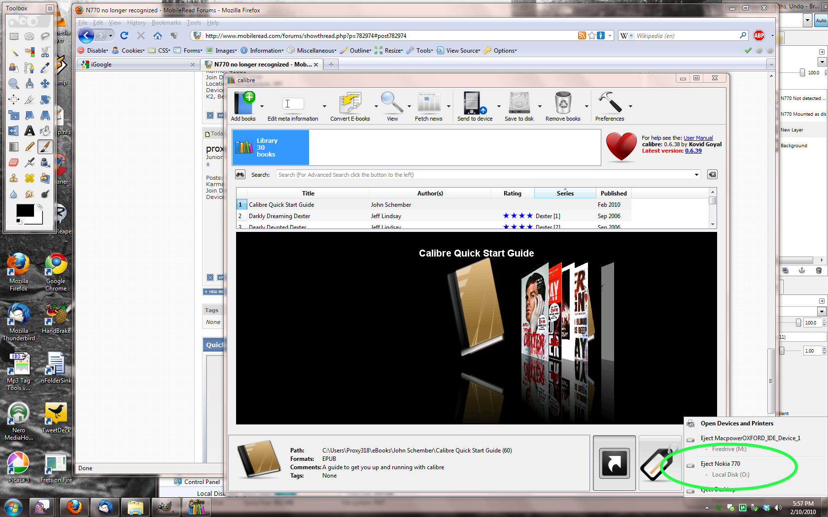

According to the debug output, it isn't.
The output is wrong. See attached image.

Old 02-10-2010, 06:59 PM   #9
proxy318
proxy318 began at the beginning.
Posts: 14
Device: Nokia 770
In case you need further proof
