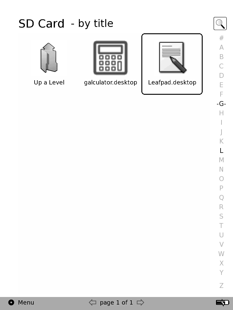

EDIT: btw, it works even with images of any size, but obviously we should use proper sizes, 60x60 for small and 120x120 for medium
EDIT2: I've included the sample python script.
Mount your DR device in your Linux computer and run as:
# python icons.py <path_to_your_DR_mount_point>
f.e.
# python icons.py /media/DR800
Eject device and that's all.
EDIT3: added a screenshot

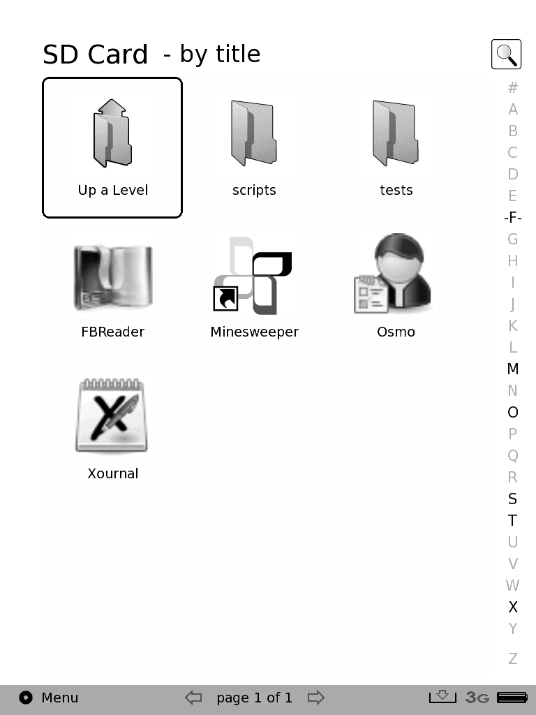

Working icons.lua script and some nice screenshots attached.
Note that currently released lua package, v1, contains a bug in ldbi.sqlite so this script won't work by now. I'll post a new lua package once I finish some helper tools.
