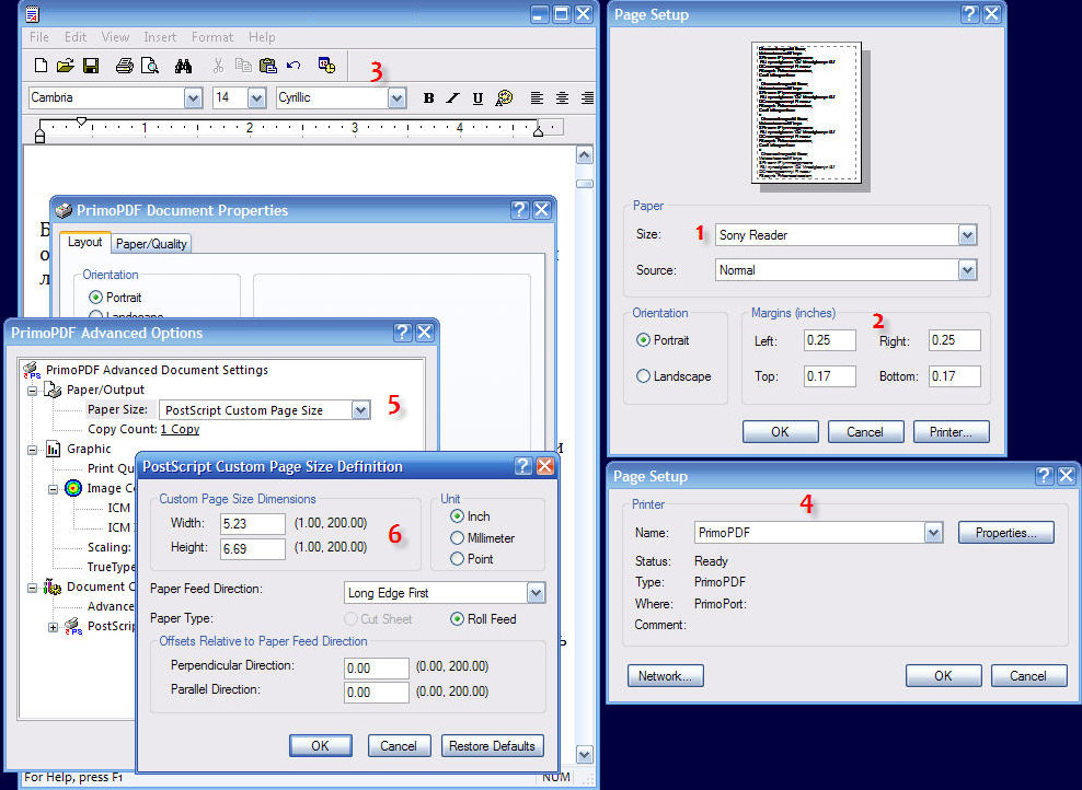

I used Primo PDF and find that when the PDF is installed on the reader, the text is too small and light to read. I have never used PDF before and was wondering what I did wrong and how to correct it so that I can read in PDF.

I assume you're printing from Word/WordPad? If so, you will need to do a couple of things (ok, may be a bit more then couple)
1) Set page size to 5.24"x6.69"
2) Set margins as small as you can (but even 0.25" is not bad)
3) Set font size to 14-16
4) Select PrimoPDF as printer and then Properties/Advanced options
5) Change Paper size to "PostScript Custom Page Size"
6) Set "PostScript Custom Page Size" to 5.24"x6.69" (it will change to 5.23"x6.69")
7) Click all the "OK" you can
8) Print the document.
9) In PrimoPDF "PDF Settings" choose EBook
10) In "Document Properties" enter Title and Author
11) Ta-da

Thank you Salva for your help on this.

Hey, Salva - wanted to add my thanks too for the tips on Primo PDF...
Any way to get the fonts appreciably larger without scaling the document? When I put the PDF in the Reader without scaling, the text was really small. Resizing it to "M" in the reader only helped a little.
I scaled the document to 110%, and the "M" setting looks a lot better - but the type is a little washed out...
Any help would be appreciated!
Larry,
I would try to
  1. setting fonts size to 16-18 (this post has some examples)
  2. setting margins to 0.02"
