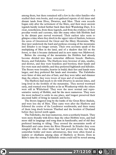

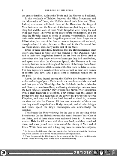

The Lord of The Rings has multiple problems. There are extra spaces added to the titles on a page, and the first line of a page is always on the next page sometimes leaving a single word on a page. I tried to use "scroll pages" in the layout menu item, but this only works if the font size is small.

Unfortunately, none of these books have columns, so the zoom won't do me any good. My eyesight isn't very good, which is one of the reasons I got an e-reader - so I can increase the font size. I usually need to use the Large or Larger font sizes, and reflow isn't working well at all.
