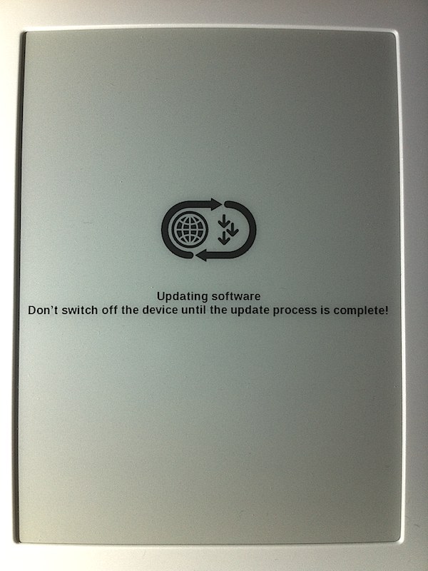

I tried to update a PocketBook 613 with Firmware 3.3. The Device is stuck at “Updating Software” and does not answer to any input anymore for hours now.
The Power button (like any other button) does not do anything.
“Reset” causes the display to flicker once but doesn’t change anything.
Does anybody know how I could reset the device to factory settings? Any other ideas?

I have never seen a 613, but if I were in your shoes I'd try to disconnect the battery

Pavajeje you can do as follow:
1. As Paola says: Remove battery (maybe you already done it )
2. download official Pocket Book 15.8 firmware from here
3. Unzip the package and copy SWUPDATE.BIN file in the root of the SD card
4. Insert the SD in the reader and switch it on
5. During the boot process press and hold OK and FORWARD buttons simultaneously until you will see a "Firmware update" message on the display
At this point firmware update procedure should take place so follow instructions.
Hoping this helps!
