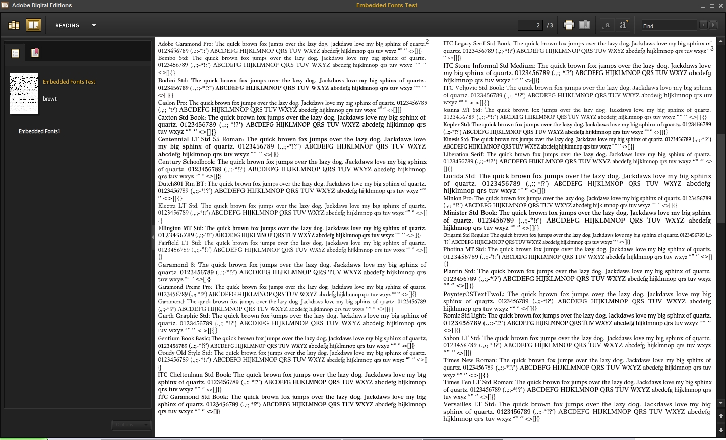

Brewt: Wondering if you've opened/saved this file in Sigil. I've been having problems retaining embedded fonts after opening and saving with that (otherwise excellent—for a free, not-even-beta program). I'm not sure what the problem is. Could it be the way Sigil renames the fonts? Either way, I'd love, at the last stage, to "restore" this embedding.
sjkramer is offline   Reply With Quote
Old 01-30-2010, 11:25 AM   #11
brewt
Boo-Frickety-Hoo-Erizer
brewt will become famous soon enoughbrewt will become famous soon enoughbrewt will become famous soon enoughbrewt will become famous soon enoughbrewt will become famous soon enoughbrewt will become famous soon enough
brewt's Avatar
Posts: 251
Karma: 686
Join Date: Oct 2007
Device: Kobo Glo HD!

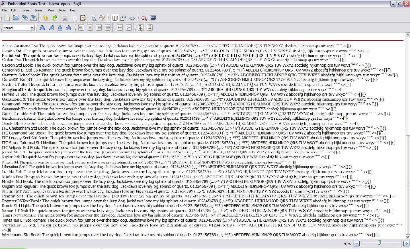

When I open the file in Sigil, I'm not seeing the embeddedness of the fonts that I see in ADE. Attached are some pix.
Also: I've got some fonts indesign says I can't embed, so even if your method worked, there are instances that it couldn't. Obvious example attached.
Funny, these all show up ok in sigil but not ade/sony.
As much fun as indesign can be, I find that it causes (me, at least) more problems than it solves.

thanks for these. Just one question, once you've saved the file in Sigil, do you still see the embedded fonts in ADE? That's where I'm running into trouble.
Old 01-30-2010, 02:59 PM   #13
Valloric
Created Sigil, FlightCrew
Valloric ought to be getting tired of karma fortunes by now.Valloric ought to be getting tired of karma fortunes by now.Valloric ought to be getting tired of karma fortunes by now.Valloric ought to be getting tired of karma fortunes by now.Valloric ought to be getting tired of karma fortunes by now.Valloric ought to be getting tired of karma fortunes by now.Valloric ought to be getting tired of karma fortunes by now.Valloric ought to be getting tired of karma fortunes by now.Valloric ought to be getting tired of karma fortunes by now.Valloric ought to be getting tired of karma fortunes by now.Valloric ought to be getting tired of karma fortunes by now.
Valloric's Avatar
Posts: 1,982
Karma: 350515
Join Date: Feb 2008
Device: Kobo Clara HD
Font embedding is still not supported in Sigil. It will be in a future release. Any current Sigil code that deals with retaining fonts should be considered experimental.

'fraid not. What it looks to me like is that the original font calls are preserved in the css, but sigil is renaming the font files to font1.ttf, font2.ttf,, etc. Some of my original fonts are otfs, if that makes a difference, too.
xhtml:
<p class="style1"><span>Bembo Std: The quick brown fox jumps over the lazy dog. Jackdaws love my big sphinx of quartz. 0123456789 (.,:;-*!?’) ABCDEFG HIJKLMNOP QRS TUV WXYZ abcdefg hijklmnop qrs tuv wxyz “” ‘’ &lt;&gt;[]{}</span></p>
css:
color: rgb(0, 0, 0);
display: block;
font-family: "Bembo Std";
font-size: 1em;
font-style: normal;
font-weight: normal;
line-height: 1.2em;
margin-bottom: 0;
margin-left: 0;
margin-right: 0;
margin-top: 0;
text-align: justify;
text-indent: 0
content.opf call:
<item id="font001.otf" href="fonts/font001.otf" media-type="application/x-font-opentype"/>
I can't see way to preserve the original connection - rebuilding it to match the original would be a bothersome chore at best, assuming the encryption scheme survived. I haven't tried it yet, but my off-the-cuff guess is no, it wouldn't.
What are you trying to do in sigil to make this work? I know their meta tags are extensive; what else are you after?
