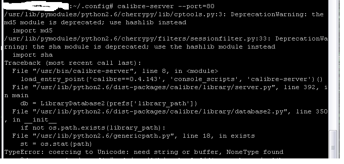

Trying calibre-server --port=80 give me errors is attachment.

I'm getting a segmentation fault when trying to pass arguments on the command line to set the port number and library location (see attachment).
EDIT: doesn't matter if I pass arguments or not either way I get a segmentation fault in libc-2.10.1.so

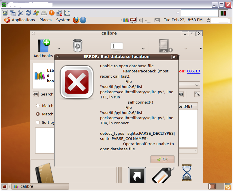

Since I couldn't make any head way configuring Calibre through the cli I tried to do it through a GUI and I get an error when I try to create the library and can't go any further.
