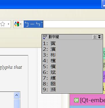

The table is ok. For Chinese language, it's common that multiple glyphs have the same pronunciation. Zhuying IME is based on each glyph's pronunciation. The pronunciation of the above glyphs are all the same, so they have the same input combination. When two or more glyphs have the same input combination, the screen will pop up a menu for users to pick one glyph by number keys. The attached image is a example using Zhuying IME to input "1up".

As to visual feedback, definitely it exists for most circumstances.Take Zhuying IME for example, when a user type a key, say "J", there will be a small box showing the respective Zhuying symbol. When a combination is finished, a glyph will show up. If multiple glyphs have the same combination, a pop-up menu will come out for users to pick a glyph. Although this feature (visual feedback) is convenient, it is not a necessity. But a pop-up menu is a must-have. For skillful people, they don't have watch the screen to input correct glyphs.
