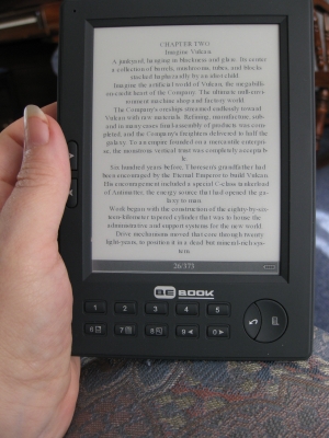

A week ago, I received a BeBook Mini -- the new 5-inch reader built by Hanlin, which means that the hardware is the same as the Astak Pocket Pro. My BeBook arrived via FedEx from Endless Ideas in The Netherlands and I tore into the box to see what was there. Obviously, the reader was in the box; it was *on* with the User's Guide displayed, and the battery status icon indicated that there was 3/4 charge in the battery. Also in the box were a USB cable, headphones, a screwdriver to remove the battery cover, and even a couple of extra screws.

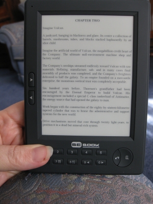

The functions and capabilites vary depending on the book format. For example, compare the menus displayed when reading ePub and Mobipocket books:
The ePub menu is on the left; Mobipocket on the right. ePub menu option 4 "Go to Catalog" lists the TOC with each item given its own menu option, while Mobipocket menu option "Go to ..." lists the guide items such as "Table of Contents", "Cover", and "Start Reading". Selecting a chapter is a two-step process for ePub books and three steps for a Mobipocket book.

  • The manual says there are 5 font sizes, but ePub books cycle through only 4 sizes in portrait orientation; 5 in landscape/rotated orientation. And Mobipocket books only cycle through 3 sizes and don't rotate at all.
  • The Mysterious Affair at Styles downloaded in ePub format from here at MobileRead always opens to the cover, but other books -- both ePub and Mobipocket -- keep their last position after changing books and then returning.
  • Support of MS Reader (.lit) books appears to be very poor. Every line is centered, and it takes a *long* time to open books in this format.
