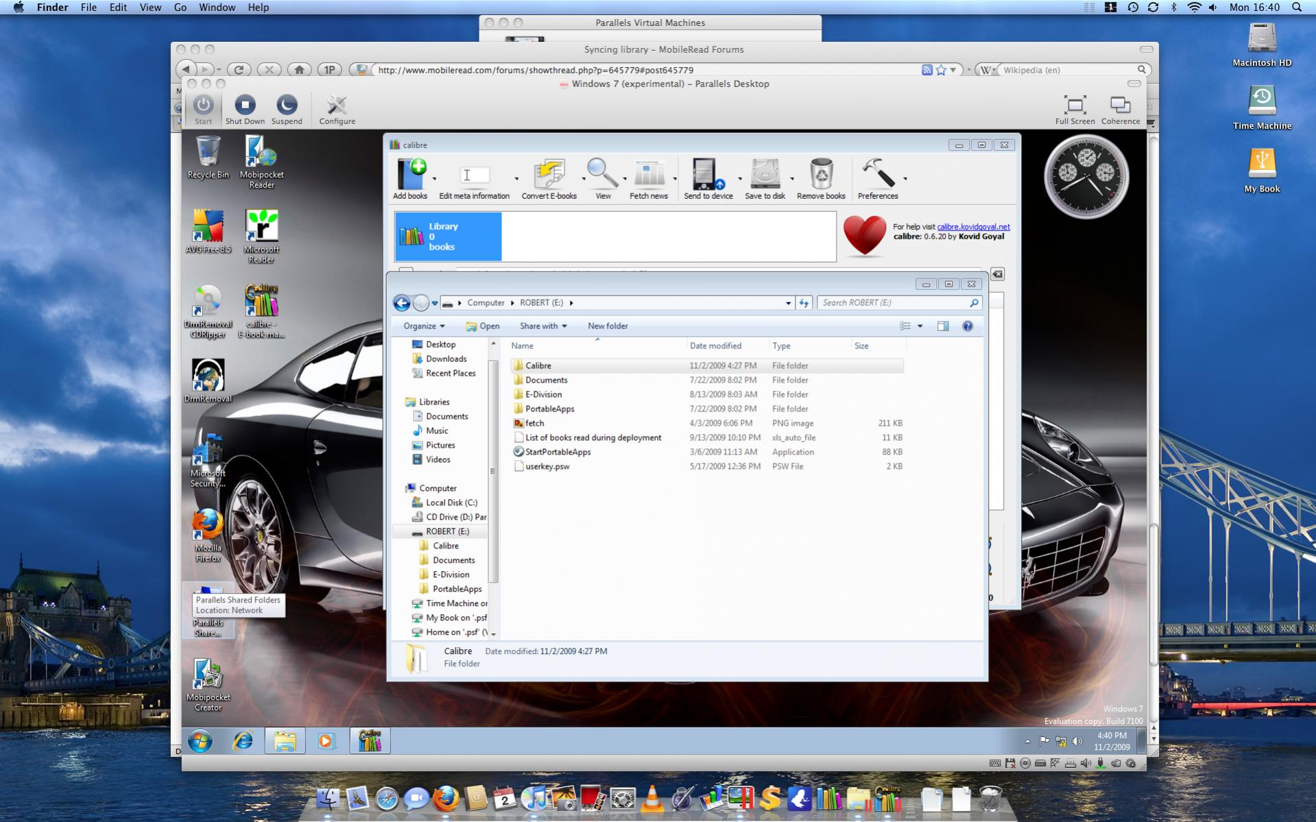

Originally Posted by mfaine View Post
I was able to get it installed on a USB drive and it seems to work though it is quite a bit slower. Also, rcuadro, how were you able to get the installer to install to a usb drive? I tried but the installer specifically said that it had to be a hard disk and would not allow it.
Well I'll be damned... it sure does not let you install it right to the USB drive. Huh, I guess I did it a while ago (March this year).
However I just installed it on my computer and then copied the directory to the USB drive and it worked fine... though a little slow thought that would be expected.
Attached is a screen shot... this is on Windows 7 running on Leopard under Parallels
Name:	Screen shot 2009-11-02 at 4.40.22 PM.jpg
