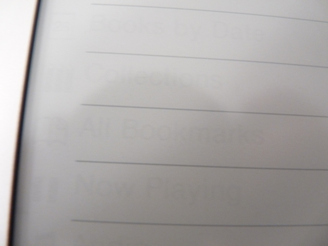

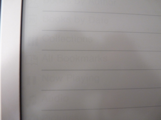

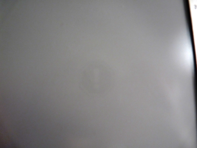

Here I took some pictures. They are not too good maybe, but I did what I could, the flash would do no good. Also I have to say, when the device is off, and I mean off, not just in sleeping mode, (I go to settings and turn it off), it still shows the last page it was on before I turned it off, just like a ghost, faded away. In this case the warning sign when you turn off the device. The first picture shows that. The second the regular menu and the next two show the ghostly words.
What do you think?

Thanks for the pictures. To me it looks like acceptable ghosting and about what I expect from the 505's generation of e-ink (I have one too). Like I said, the ghosting can be more or less pronounced depending on the reader's/ambient temperature and on how it was configured before it left the factory - the e-Ink controller has waveform data that is matched to the display material. Also there is a temperature compensation that is unique for every display, so try letting your reader "warm up" to room temperature and see how you get on.
For some more information about this waveform and ghosting stuff (although it is geared towards irex's iLiad) see this page)
If you feel the ghosting is really too much (try reading a couple of books) you could contact Sony again.
Here's a bit from the Sony reader FAQ on the MR wiki:
Has Sony experienced any issues with “ghosting”?
Please refer to the FAQs on the E Ink web site (www.eink.com) to understand the causes and effects of “after image” (ghosting). While our engineering objective is to minimize the after image effect through clever control waveform design, after image is an inherent characteristic of the E Ink technology and is not a sign of a defective or degraded display.
