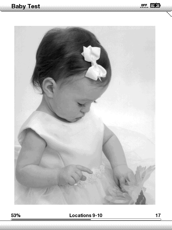

I saved the 5 MB jpeg and made 600x800 jpeg and png files from it (no other adjustments). I then used all the images (orginal, jpeg and png) files to make a photo album with MobiPocekt Creator (I did not load the images as screen savers but the results are similar except for the border around the images).
I'm attaching the photo album along with screen shots of how all 3 versions of image looked on my K2. All of the images look good to me, No splotchiness.

Well, I didn't do anything to the grayscale. I only reduced the size. I even install color images "as is" (except for size) on my Kindle. I don't convert them to grayscale.

I agree, this photo renders very blotchy and poorly dithered on my K2 as well, and enabling/disabling dithering appears to do absolutely nothing?!
Simply resizing didn't help it on mine either. I had to actually go into photoshop, resize it, and then manually dither it by using "Save for Web & Devices..." and manually loading the K2 15 (well, 16 with two whites) color table (attached). After this, then the photo rendered as expected.
