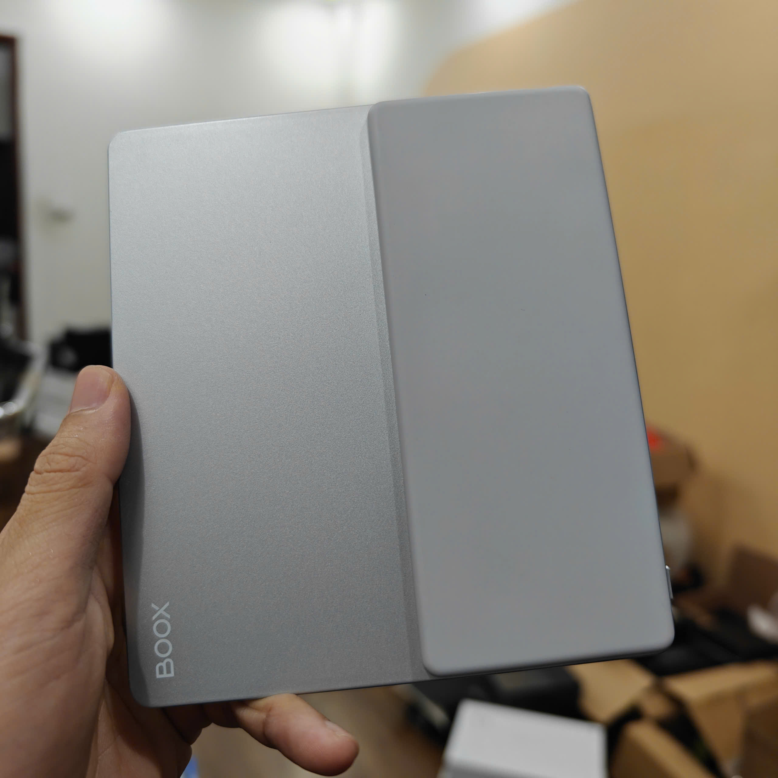

Hi everyone. I have a Leaf5 and would like to try converting it to the new-released Go7. Both have same 750G soc, 4gb ram, 64gb Storage, 1300 carta screen.
I have managed to pull out the libota_jni.so file from go7 for Booxkey.csv since I dont see it in the list yet (attached). I also got the update upx of Go7 also.
http://firmware-us.boox.com/b2428311b9af44129fdfc5130864955c/update.upx
md5":"b2428311b9af44129fdfc5130864955c"
Could you guys help me? Thank you

Got your custom rec for go7. It works smooth on Leaf5. The screen goes black after reboot to rec.
adb shell
# id
# start autoupdate
Screen show text, straight up, waiting for drive ....Flash succeeds and device reboots
However, the screen touch doesnt work. Maybe it's because go7 has stylus function (it has wacom pen) and leaf5 doesnt. Everthing else work fine, i use a mouse with a usbC to test it. Do you have any idea to flash or somehow make the touch work on leaf5?
