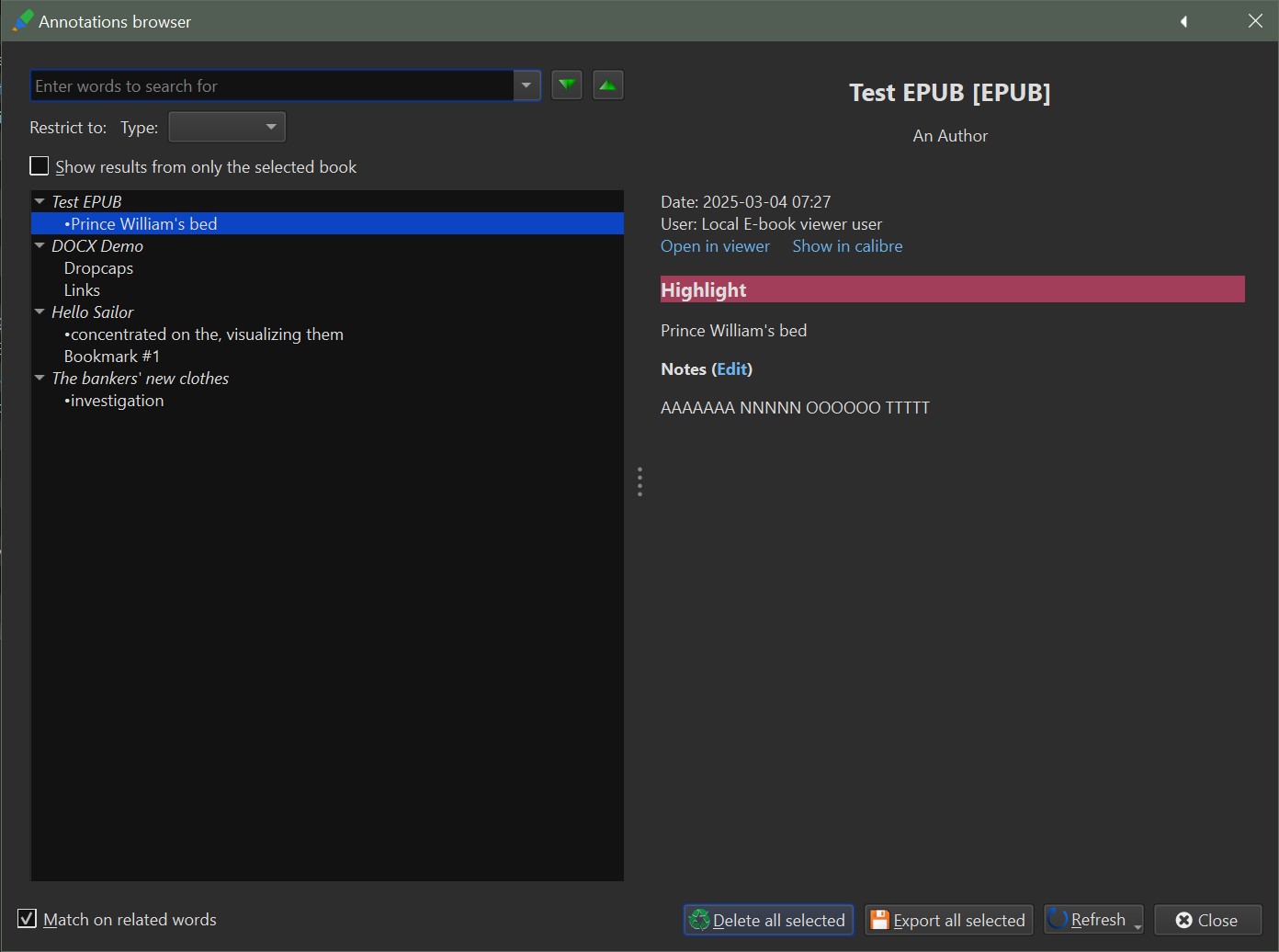

AFAIK Annotations are not stored in the 'comments' table, they're stored in the 'annotations' table which can be viewed in the Annotations browser which has a Find feature:
Name:	Screenshot 2025-07-06 105455.jpg
You need to add Browse annotations to a toolbar/menu or use a keyboard shortcut (default is 'B') to pop that dialogue box.

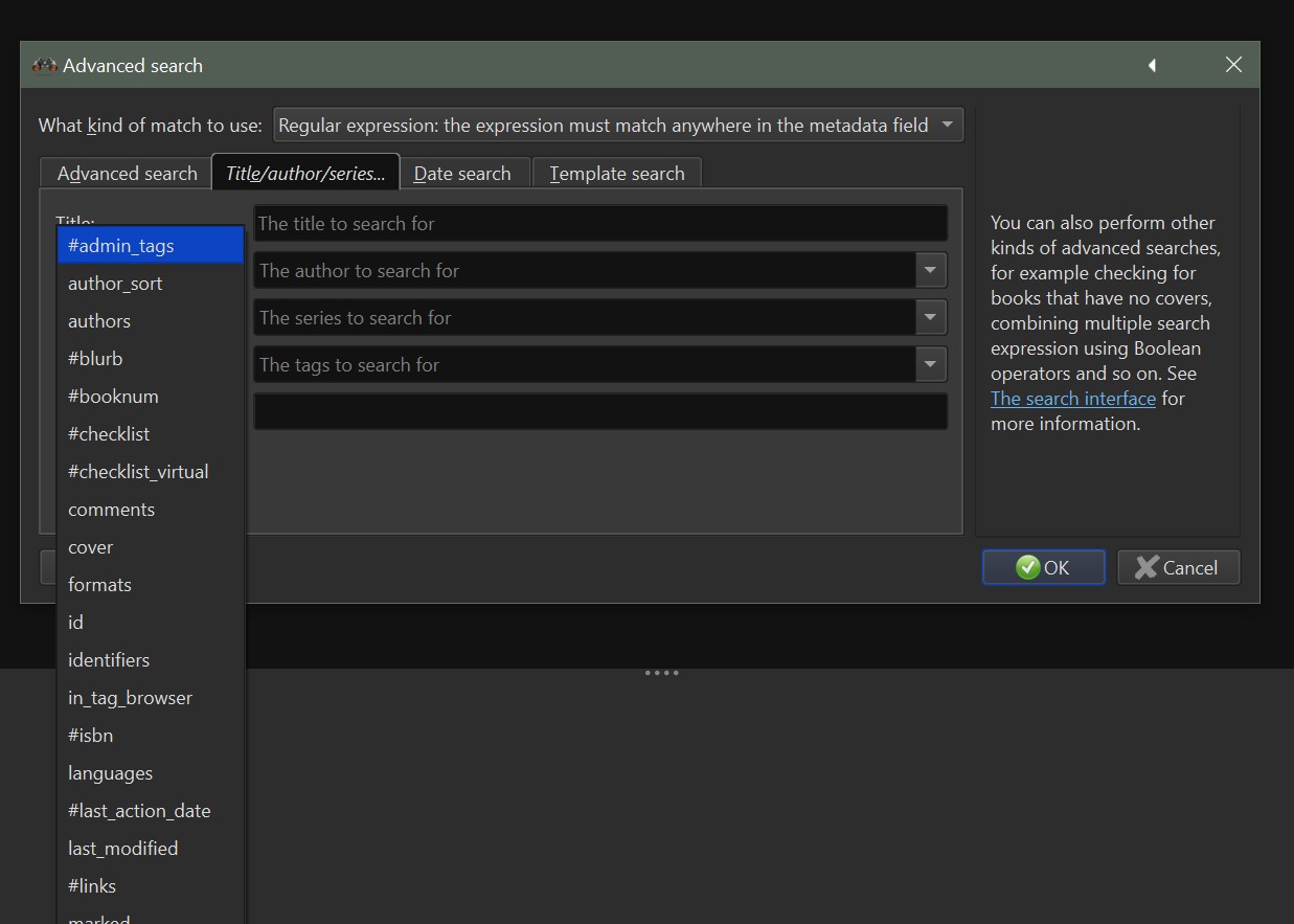

And, AFAICT 'annotations' are not available to the Book list search feature:
Name:	Screenshot 2025-07-06 110136.jpg
