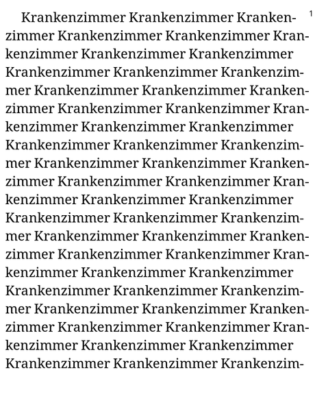

Is your document language set to German? (Top menu, 2nd tab, Typography rules: German).
I tested your example and it worked fine (see attachment).

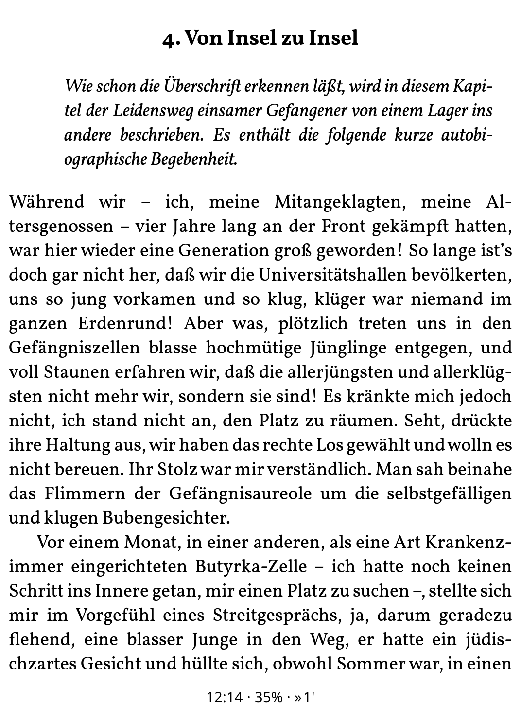

Yes, the document language is German. I can see that the hyphenation dictionary properly contains "Kran-ken-zim-mer", but somehow it is rendered falsely.
Attachments: This is how it renders for me. Also, "jüdis-chzartes" on this page is not hyphenated correctly too. As you can see, the hyphenation dictionary is not the issue, but something else.

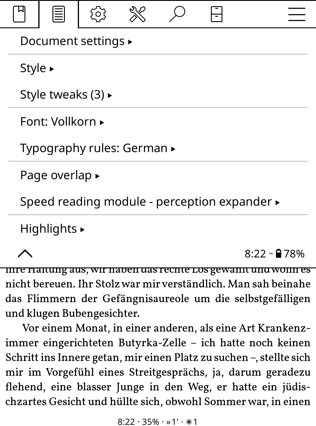

I did verify it's set to German, I just didn't bother sending a screenshot for this since it's a trivial task. But if it's needed, I attached another screenshot.
I couldn't find a hyphenation error in a short test text I made, but as said, it's not all words that are hyphenated incorrectly. I would share the document in the screenshot, but I'm afraid MobileRead forbids this, as the author died too recently.
