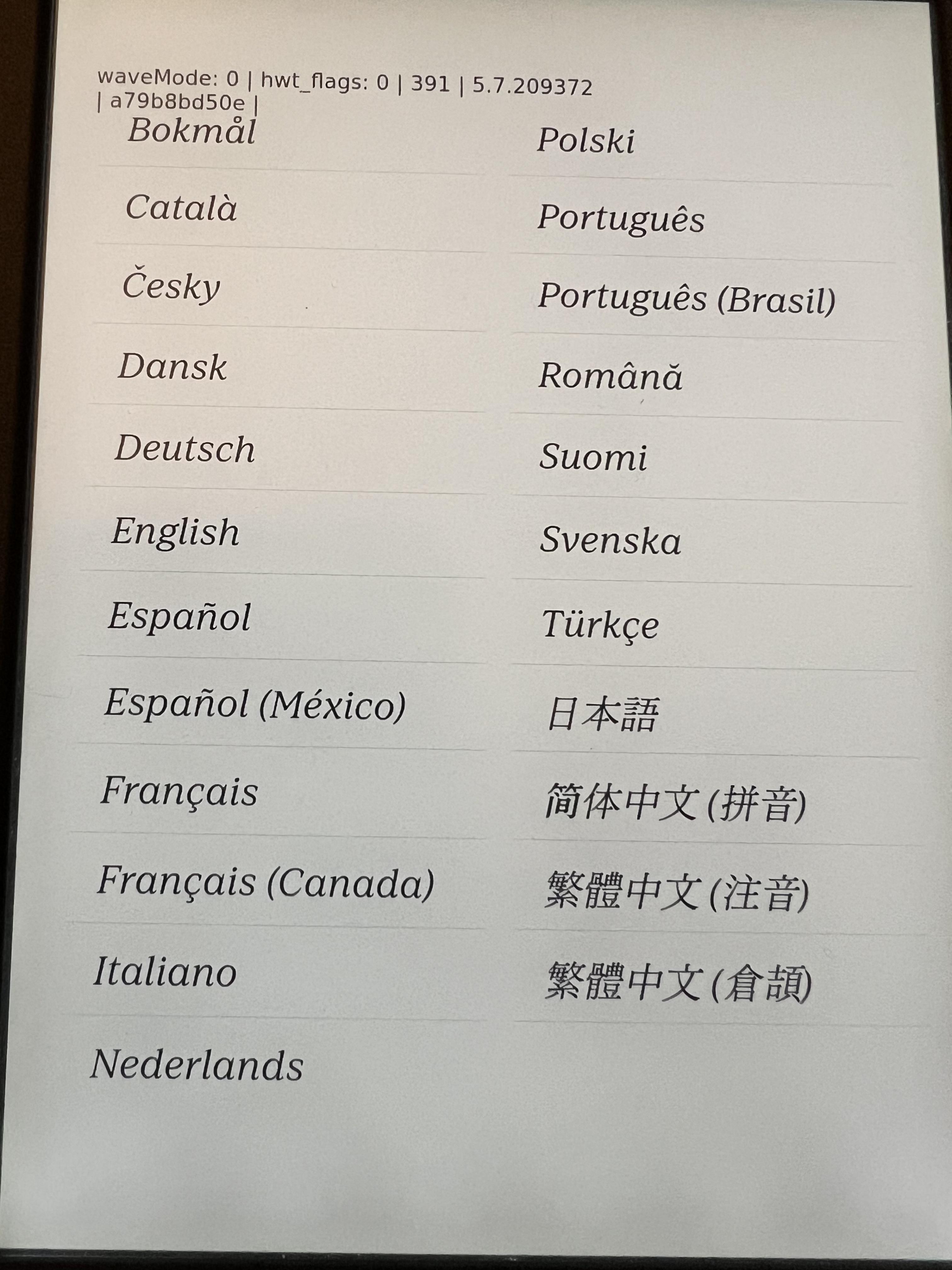

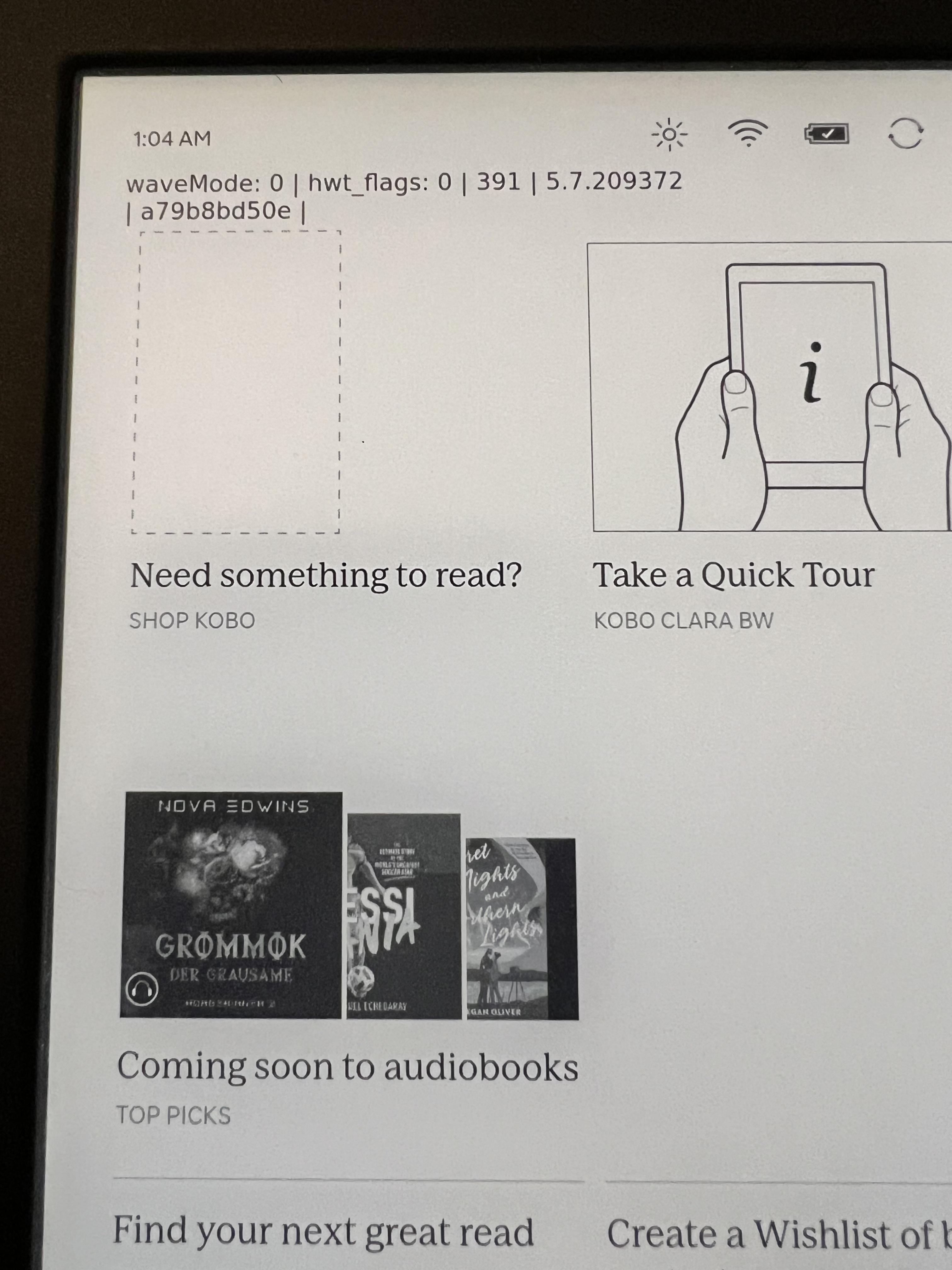

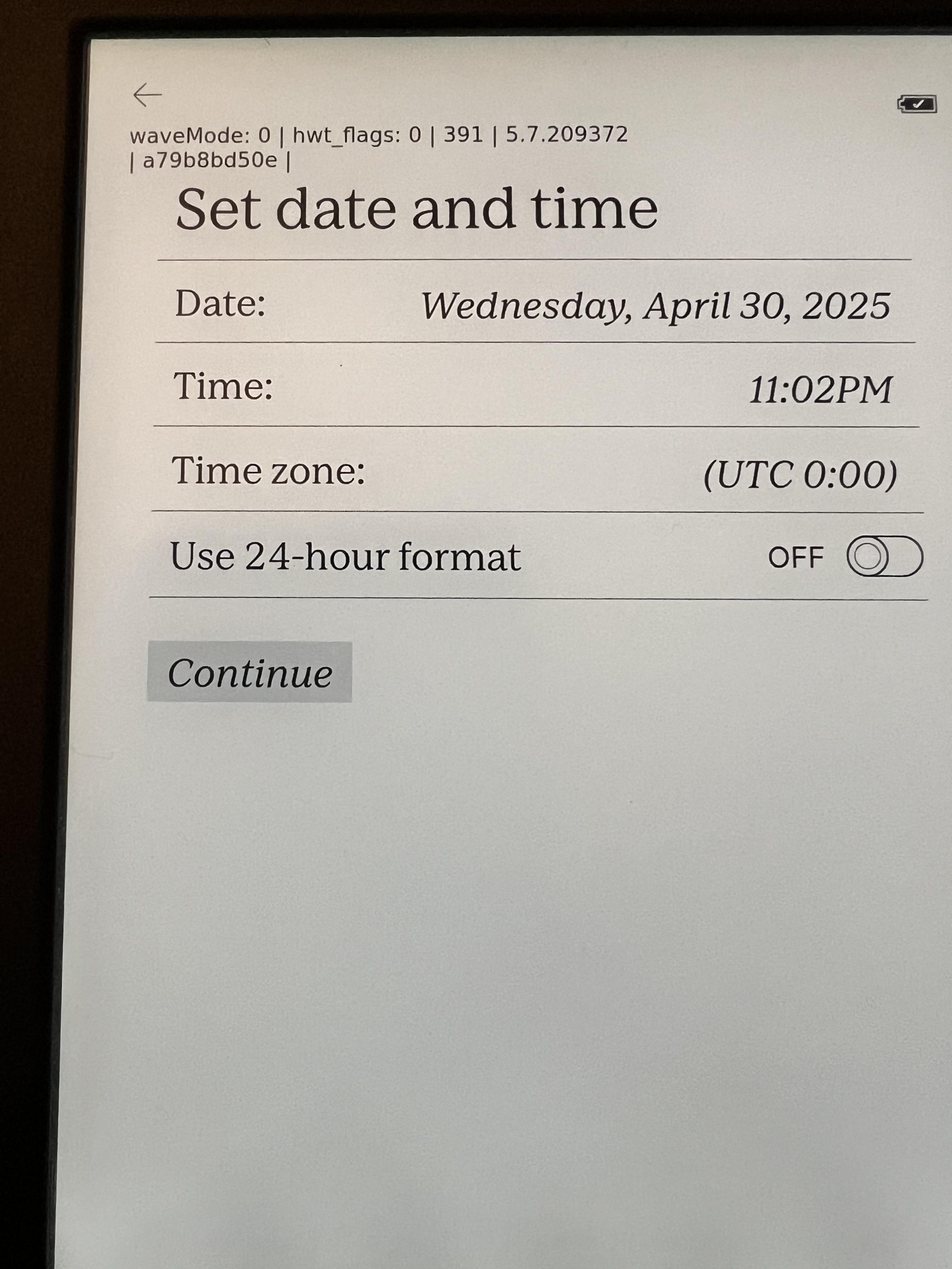

I have a Clara BW, which I've tinkered with, activating devmode. Now that I want to sell the device, the devmode stubbornly remains on, after resetting the device to factory settings (see image below) and although I can manually turn it off, this can only happen AFTER activating the device and logging in.
Is there no way to properly reset to factory condition, and get rid of this pesky DevMode ON that won't quit?

Yes, and yes, I did turn it off before resetting, several times, and also reset from the developer options, while in Dev Mode - same result

Thank you so much, David, for such a detailed reply! I’m afraid some of it is flying right past my head, in terms of what is it suggested I should do.
I should try to copy the content of the Kobo folders from the device, then format it, copy back and try the steps again?
In terms of reset, yes, 100% certain that I’ve done it properly, as per steps you describe, both from the regular mode but also from the devmode, with the same result: it still start with those devmode texts at the top.
Would it help, give any clues, to look at this screen photo in the link at the end or this post showing the software version? I wonder what that “not for MP” means and if this version showed is the proper one.
I’m assuming that on Kobo Clara BW, there is no reimaging option available at all, no way to wipe clean the latest firmware installed?
For more background, I tinkered with devmode some months ago, around end of Feb, and at the time it was enough to just turn it off, but now that I’d like to sell the device, which I’m not using much since also getting a Libra, I cannot really sell it to someone who will see this strange start screen, even tho all other features seem to work as intended.
