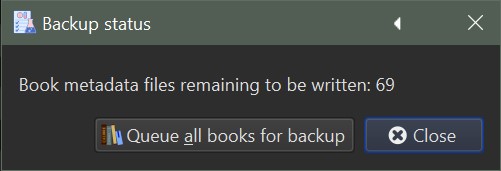

The metadata.opf files are written in a separate background thread…known as 'lazy writes'. Last time I looked it they were written at intervals of about 2 secs. If calibre is closed whilst there are outstanding metadata.opf writes the process will continue next time calibre is started.
@abrogard - the Library maintenance->Library metadata backup status action will report how many are outstanding.
The calibredb backup_metadata command can be used to flush outstanding lazy-writes of metadata.opf files. I include it in my daily backup process.

Something going on with your system, I just added and deleted a couple of tags, pressed OK and the MDE dialogue was gone instantly… no delay.

And I just did a bulk change to a tag like column to 97 books in my Test library - again when I pressed OK the bulk MDE was gone instantly. Here's a screen shot of the Library metadata backup status :
