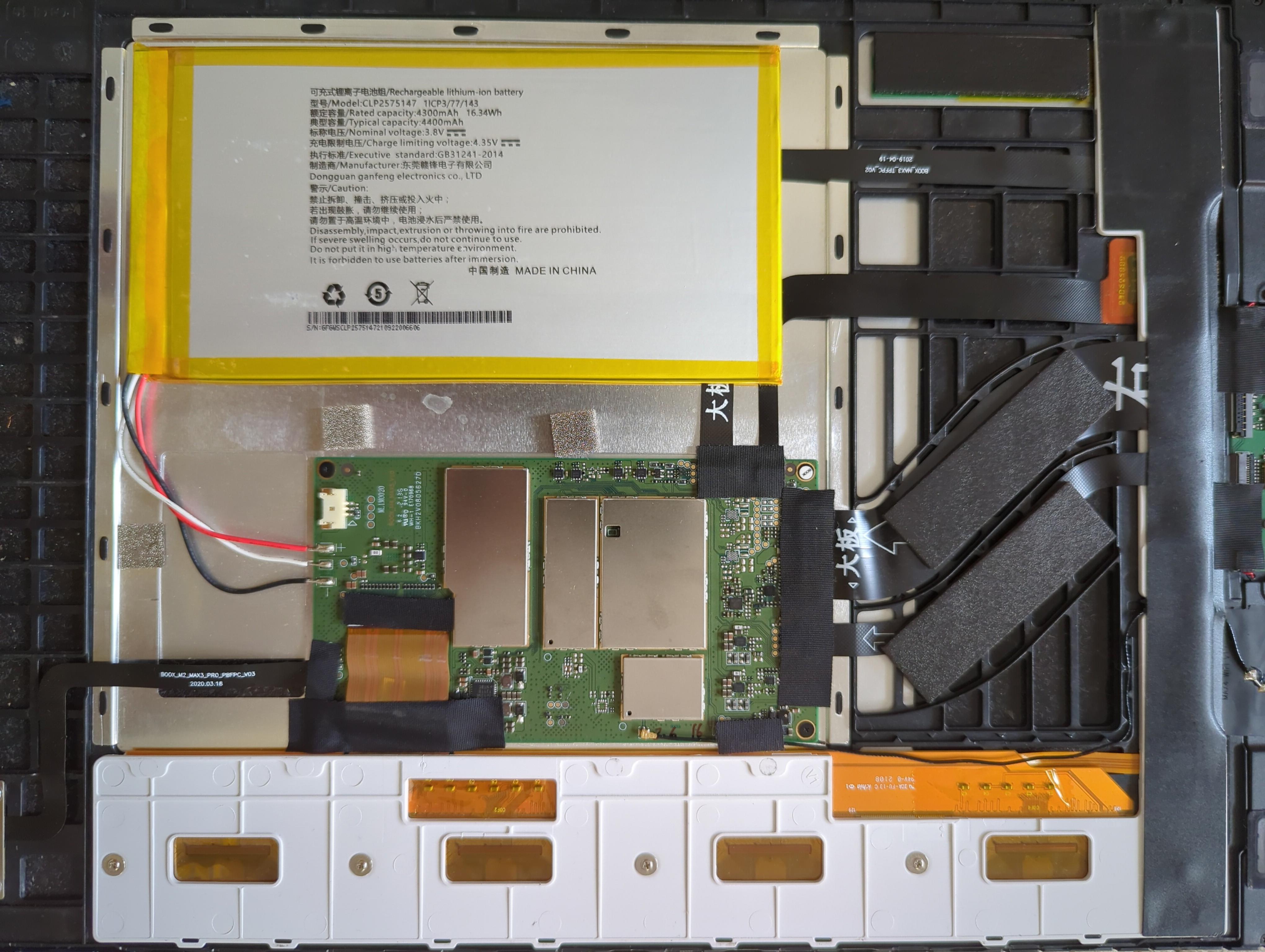

Hey everyone!
I need to replace the batteries on my Max Lumi 2.
Can someone explain to me which battery models are compatible and what configurations are possible?
Thanks.

Forgot to rotate the photo

Most Onyx seem to use thin (thinner than common) batteries, 2.5 mm.
Battery numbers are only dimensions. CLP2575147 = 2.5 mm x 75 mm x 147 mm.
Loose wires like that are dangerous. They cheaped out even though there is a connector on the PCB.
The white wire is probably a 10 k NTC thermistor to the black wire.
When you replace the battery double-check that the temperature reads something sane in a utility (like my UsbMode.apk in the sig).
