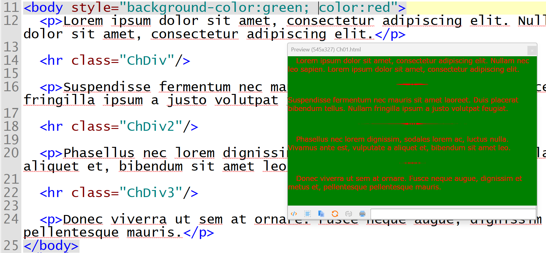

Hi all!
After playing around a bit I thought I'd post my results in case anyone else was interested.
I built this using ePub2. If you are creating an ePub3 only book then you could possibly use javascript. The device/app would also need to support some specific css...so, definitely test on your device...
Using fill:currentcolor and stroke:currentcolor in your css works but only under certain circumstances.
In an ePub you could embed the svg code directly in the html page:
svg path, svg stroke {fill:currentcolor; stroke:currentcolor}
<p>yadda yadda</p>
<svg><g><path d="......"/></g></svg>
<p>yadda yadda</p>
Unfortunately, the last I heard, some readers/apps (kindle) don't support embedded svg very well. They want you to wrap the svg in an <img> tag (<img alt="" src="img.svg"/>). The value for currentcolor wont translate into the <img> tag. Also, embedding all that svg code can get a bit clunky, especially if you are using it a lot.
After practicing a bit more google-fu I found that you could use image masks in your css and simply set the backgound-color to currentcolor. Image masks are almost universally supported in browsers (except IE...go figure...), so there is a decent chance they will work on your device/app as well! The downside is that you are limited to fairly simple, monochrome style, images...but since these are used for scene breaks, and we're mostly worried about a dark image on a dark background, that's not too bad.
hr {border:none; margin:1.5em auto; text-align:center; overflow: hidden;
    page-break-inside: avoid; break-inside: avoid}
    //*This is just the defaults I use for an hr...style yours however you wish *//
hr.ChDiv {
    height:.3em;
    background-color:currentcolor;
    -webkit-mask-image: url('../Images/img_ChDiv.svg');
    -webkit-mask-repeat: no-repeat;
    -webkit-mask-size: auto 100%;
    -webkit-mask-position: center;
//* if your device doesn't support webkit,
    then you could try the non-webkit version *//
You will just need to set the height and mask-size to the proper size.
Here are a few screenshot examples:

Also, this technique is not limited to svg...it works fine with .png and .jpg...just remember it is using a mask, so none of the image detail will be visible, just a silhouette. Here are some screenshots with a .png
-webkit-mask-image: url('../Images/img_ChDiv.png')
