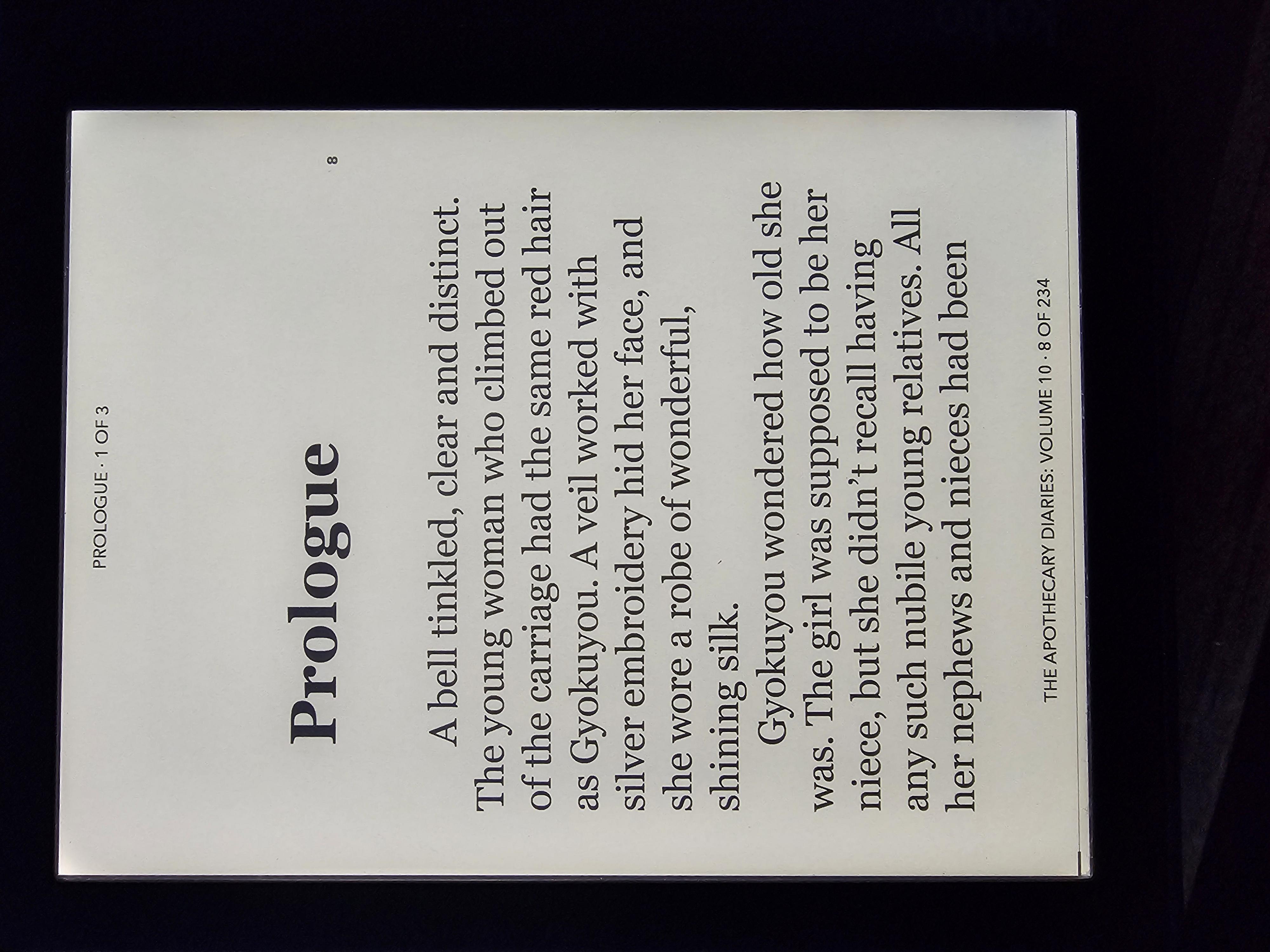

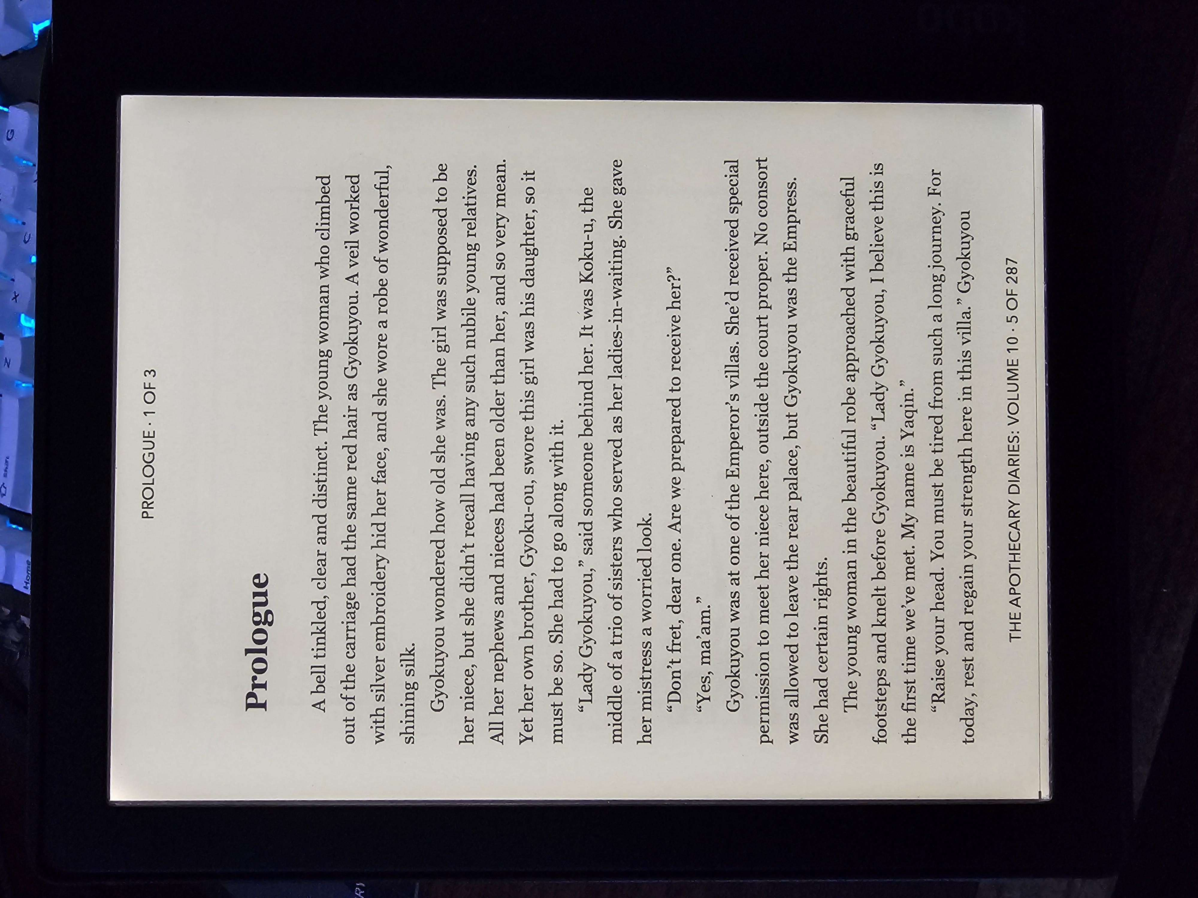

I've included some images directly from my eReader. The OLD image is how the books display after they were uploaded from my old computer and Calibre installation - default font display was smaller and there are no random numbers along the edge. The NEW image is an image of the same book and how it was uploaded to my device from the new computer and Calibre installation - the default font display is massive and there's a random number on the edge (these numbers pertain to the page number and last for multiple pages).

My suspicion is that you were using the KTE driver and sending the ePubs to your Kobo as kepubs. Your new setup is sending ePubs (the Adobe synthetic page numbers are pretty much a dead giveaway. To get rid of them, Settings => Reading Settings => remove the checkmark from Show Adobe EPUB page numbers.
You may also want to look at KoboPatch and the Unify font sizes patch to match the font sizes in kepub and ePub ebooks more consistent.
