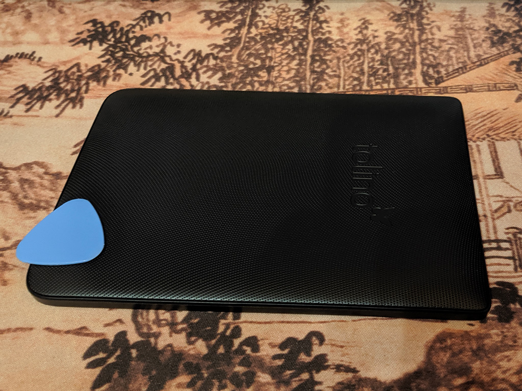

I was using my Vision 6 casually when it suddenly restarted and got stuck in a bootloop. I can however access my files via TWRP but whenever i would boot into system, the screen gets stuck in a ellipses/boot loading screen. Any ideas how can this be resolved?

Solved and thanking @Waldy for all the help, I was able to replace the sd card on my own with your videos and guide. The copy of files did seem to get better using the u3 type cards.
