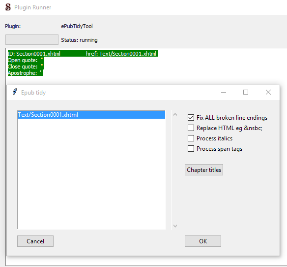

Maybe I don't understand how to use the plugin correctly or how the plugin works.
I created the following test file:

I then started the plugin and selected only "Fix ALL broken line endings" and clicked OK.
The plugin displayed the following message in the Plugin Runner dialog box:
ID: Section0001.xhtml	href: Text/Section0001.xhtml
Open quote:  "
Close quote:  "
Apostrophe:  '
but nothing got changed and both the Plugin Runner dialog box and the TK dialog box remained visible.
I had to click the Cancel button in the TK window to terminate the plugin.
Old 09-03-2015, 02:56 PM   #10

I removed my debugging code from the plugin and this seems to have caused a problem - I probably removed something that I should have left in place.
I will try to work out what has happened.

I have fixed a bug in this plugin and uploaded it to the first post in this thread.
The plugin should close automatically, update the ePub file and display the changes made in the Plugin Runner dialog box.

The new version works with Windows, but not with my Linux version (Debian Jessie), however, this is most likely caused by some incompatible library on my system or maybe because Debian Jessie comes with Python 3.4.2 and Windows with Python 3.4.3.
Can someone who uses a Linux distro other than Debian Jessie or a Mac please test the plugin with the following test file?

Select only "Fix ALL broken line endings" and click OK.

Doitsu -- I am running Arch Linux, so my python is the latest version (3.4.3).
Installed the plugin, entered your test file, ran the plugin.... clicked OK...
Open quote:  "
Close quote:  "
Apostrophe:  '
Still running and running and running.
Ah, but if I click Cancel it reports success. No changes, just success.

I believe the problem on Linux is the path specified in the plugin for the dictionary (I don't have Linux so I can't confirm this). I have updated the plugin in the first post in this thread so that when the plugin is run for the first time, it asks for the location and filename of the dictionary (see the epub in the first post for details) that is used for correcting hyphenated words that should not be hyphenated. Hopefully this will resolve the problem in Linux so that it will not run and run, nor require the Cancel button to be pressed to exit.
