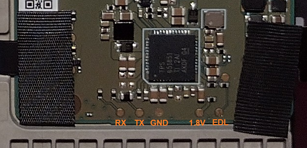

All you astute people have noticed already that the circuit board says "Poke6".
Opening the case on this is much tougher than the Poke5.
It takes quite a bit of force to open it.
This has a different processor than anything we've seen, an SM6115.
But it's part of the "Bengal" family so the same SDM662 Firehose loader works.
Currently I'm doing a full, raw backup. Done.
That way, no matter how I screw it up I can recover it.
The UART and EDL test points are as shown.

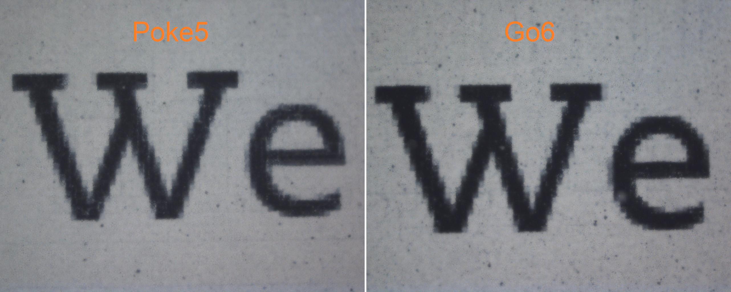

From actually reading with the Go6 I find that the blacker blacks does add to ease of reading.
I'd really like to get an accurate measurement of the reflectance vs the Poke5.
If you only have really old ereaders, a Go6 is a great reader.
If you already have a Poke5, it's a bit of a splurge to go buy a Go6. YMMV.
(And if you don't need Android and 16 GB is ok then the Kobo Clara BW (1300) looks pretty hot too.)

So, for the Poke5 vs. Go6 comparison. Here is my microscope view under the same conditions.
