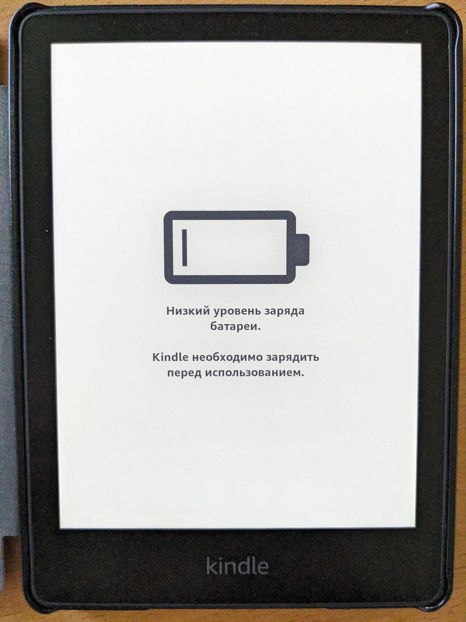

Good day,
My mum's Kindle Paperwhite 5 (2021, 11th gen) is bricked after sitting on a shelf for 6 months. The screen displays "Battery is low. Kindle needs to be charged before using" and I did try to charge it overnight, using different cables and chargers - no luck.
It used to be visible as a disk when connected to laptop, so I tried to do a factory reset by copying file DO_FACTORY_RESTORE and now it's not even recognizable as a disk.
I tried to press the power button for 40 seconds (and more), the indicator changes color from green to yellow, blinks, the screen changes backlight level and goes back to "Low battery" in ~15 seconds.
Is there anything else to try?

My only guess is that you need a new battery. It's not unusually that batteries go dead after a long discharge. I'm also guilty of leaving my devices in the drawers for extended periods, I've successfully saved a few of my devices, after that, but I've also had a few fails doing it.

Do you have a cable that shows the watts on a charge? If you do, you can see if it's actually charging or not.
No. What would it change though?
Oh okay, that might be the case. I'm still surprised the backlight works fine and judging by the the indicator, it looks like it's charging to some point and then stops🤔
That would show if it was charging.
