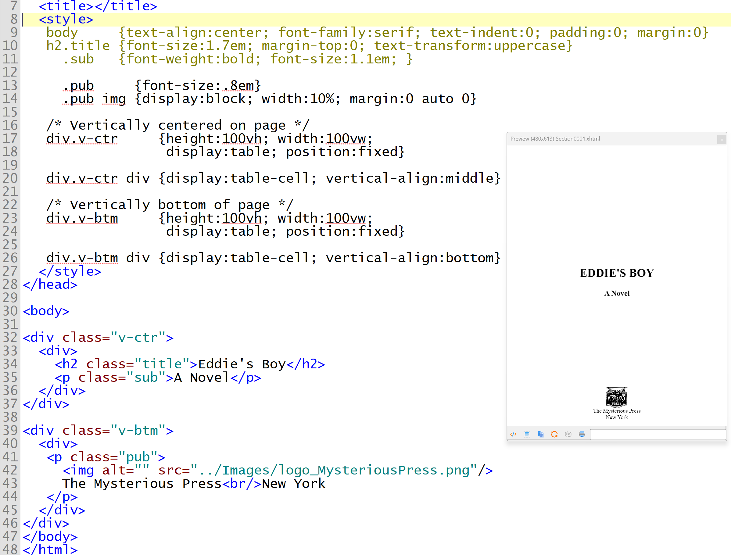

So, I've given a few examples on how to vertically center the text on the page (search the MR threads for a more in-depth discussion). Such techniques work fine and follow the ePub2 rules, but you may have issues with a particular brand of device (ePub on Kobo rings a bell). You can easily modify that technique to put it at the bottom using vertical-align:bottom.
If you are working on an ePub3 book, then it may be a little more elegant to use display:flex rather than the display:table technique.
CSS:
  div.v-btm     {height:100vh; width:100vw; display:table; position:fixed;
                 padding:0; margin:0; text-indent:0}
  div.v-btm div {display:table-cell; vertical-align:bottom}
  div.v-btm .ctr{text-align:center}
HTML:
<body>
<div class="v-btm">
  <div>
    <p>Text at the bottom of the page.</p>
    <p class="ctr">Text at the bottom of the page and centered.</p>
  </div>
</div>
</body>

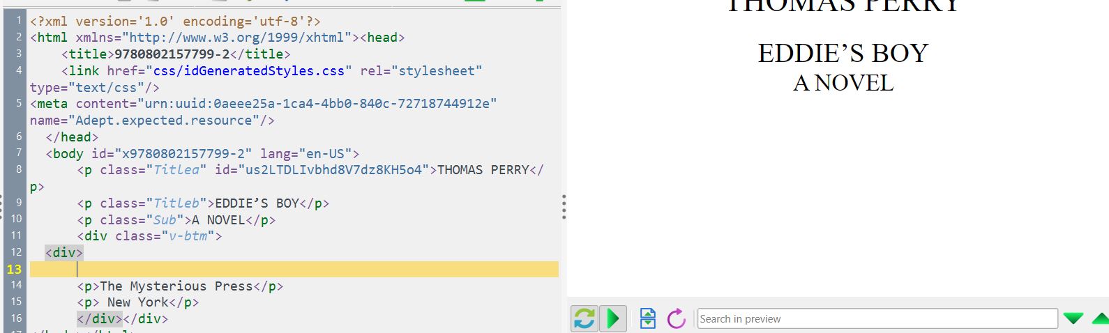

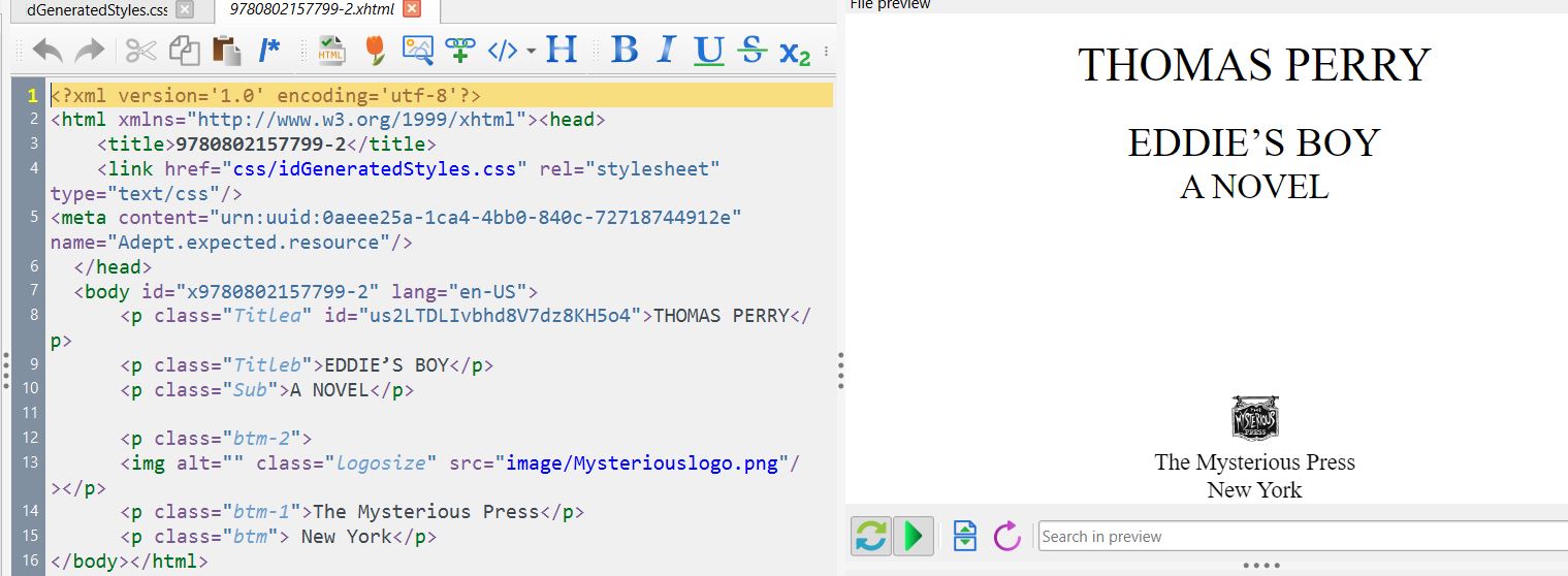

That isn't working. Text (or text and img) vanish -see screenshot. This worked:
img.logosize {
  height: 36px;
  width: 37px;
.btm-2 {
  position: fixed;
  bottom: 2.4em;
  width: 100%;
  text-align: center;
.btm-1 {
  position: fixed;
  bottom: 1.2em;
  width: 100%;
  text-align: center;
.btm {
  position: fixed;
  bottom: 0;
  width: 100%;
  text-align: center;
I'm probably making some obvious mistake.

The technique I gave seems to work fine for me (see attached).
You didn't mention that you wanted two different placements, a top and bottom. In that case you need to make sure you delineate the different sections...I use a div on the attachment to place one section vertically centered, and the other vertical at the bottom.
Using margin:0 auto can sometimes help when centering an image.
CSS:
body       {text-align:center; font-family:serif; text-indent:0; padding:0; margin:0}
h2.title   {font-size:1.7em; margin-top:0; text-transform:uppercase}
  .sub     {font-weight:bold; font-size:1.1em; }
  .pub     {font-size:.8em}
  .pub img {display:block; width:10%; margin:0 auto}
div.v-ctr, div.v-btm {height:100vh; width:100vw; display:table; position:fixed}
   /* Vertically centered on page */
div.v-ctr div {display:table-cell; vertical-align:middle}
   /* Vertically bottom of page */
HTML:
<body>
<div class="v-ctr">
  <div>
    <h2 class="title">Eddie's Boy</h2>
    <p class="sub">A Novel</p>
  </div>
</div>
<div class="v-btm">
  <div>
   <p class="pub">
     <img alt="" src="../Images/logo_MysteriousPress.png"/>
     The Mysterious Press<br/>New York
   </p>
  </div>
</div>
</body>
I had set up the top portion as "normal" CSS, not fixed position. Why did you make the top fixed (necessary or preference)?
I tried surrounding the top portion with <div></div> (otherwise leaving what I had at top, with your bottom code), but that didn't help
I'm puzzled why my more manual version worked, but your code didn't.
Any idea why the logo and text vanish for me with your code?
I'm confused. I could well be making a stupid mistake, but I'm missing it.

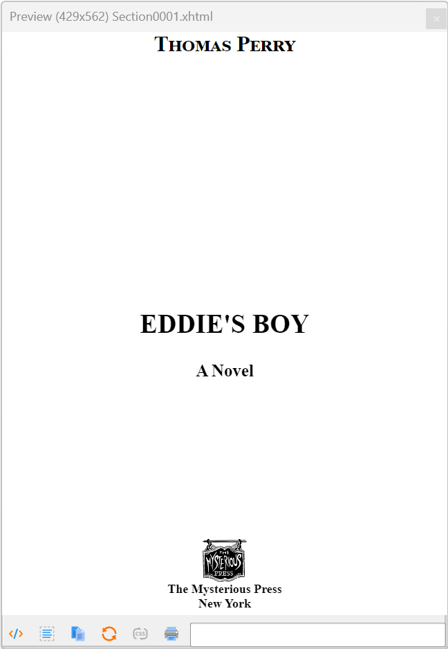

I'm using display:table, so I can use display:table-cell....that allows for vertical alignment using vertical-align:middle/bottom.
Your css above didn't have the definitions for classes: Titlea and Titleb...but I think I found the problem.
I noticed I hadn't included the author name on my example so I added that... (see attached) it also shows that you can have stuff aligned at the top, middle, and bottom all on the same page.
Name:	Screenshot 2024-09-15 104817.png
While making this example I remembered the discussion that we had on the other threads in MR about vertical centering that the rendering engine could calculate display space out of order... eg, it can report to the ePub that there are 1600 pixels available for viewing height (vh) but then reserve some of that space for headers/footers/inspector widgets/etc. If the ePub calculates the formatting based on the 1600 pixels then the bottom of the display can be covered with the widget/footer.
On this example I changed the vh to 95 (95% of viewable height) to account for any lost space due to the renderer mis-reporting. This will leave a little bit of space at the bottom, but should look fine.
CSS:
body, p  {text-align:center; font-family:serif; font-weight:bold;
h2.title {font-size:1.7em; text-transform:uppercase}
  .auth  {font-size:1.4em; font-variant:small-caps}
  .sub   {font-size:1.1em}
div.v-ctr, div.v-btm {height:95vh; width:100vw; display:table; position:fixed}
HTML:
<body>
<p class="auth">Thomas Perry</p>
<div class="v-ctr">
  <div>
  </div>
</div>
<div class="v-btm">
  <div>
   <p class="pub">
   </p>
  </div>
</div>
</body>

Can you do this so the code works with both ePub2 and ePub3?
This does work for both as long as the ePub2 supports display:table, which I'm pretty sure they all do. If it is an ePub3 only reader, then you could use display:flex for a cleaner, more elegant, solution.
The way most title pages are done is to use a graphic image. Make it hi-resolution and you can have whatever at the top and whatever at the bottom and centered. The middle can also have whatever it is you want. The CCS and code to display a full page graphics is trivial.
Yes, sometimes that is easier...especially if there are a lot of graphic elements on the title page. If there are only a few graphics, like a publisher logo, then it is cleaner to just use text and insert the image as we have here. It reduces the ePub file size without needing another hi-res image and the text itself will be very clean no matter the display size.
edit: corrected ePub3 to ePub2
Old 09-15-2024, 12:58 PM   #15
Posts: 80,816
Karma: 150249619
If this is for an eBook for sale, then you have to use what works for ePub2 and ePub3.
