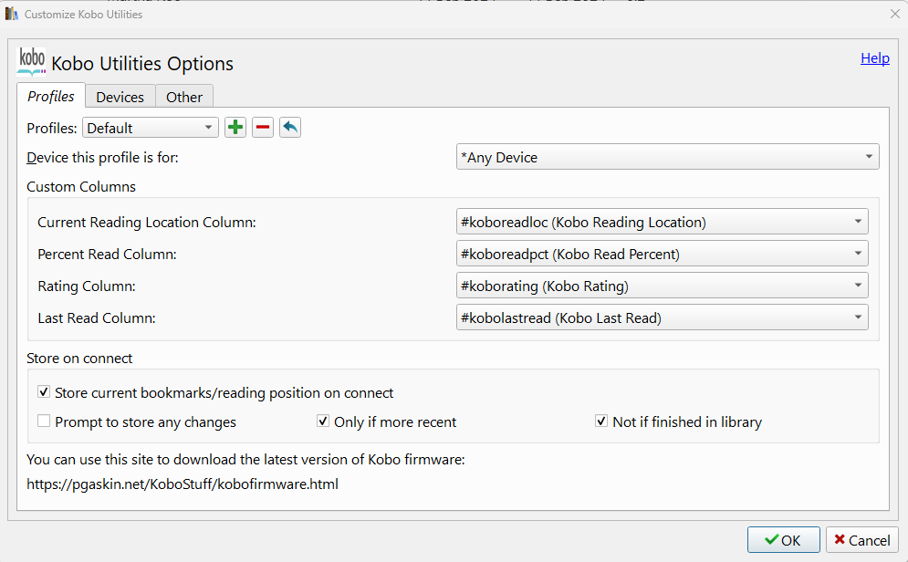

As for the bookmark restore, did you configure the needed custom columns and Kobo Utilities is configured to use them so you have some data to restore? See 1st attached image. the 4th image is what the columns look like in my calibre library view.

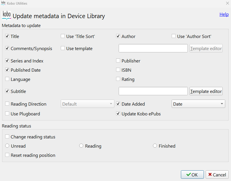

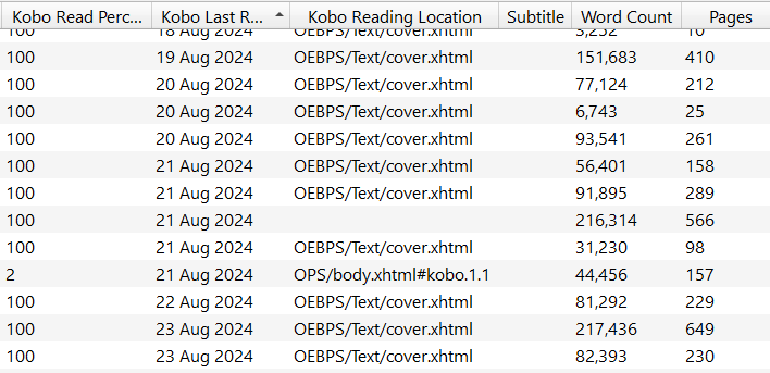

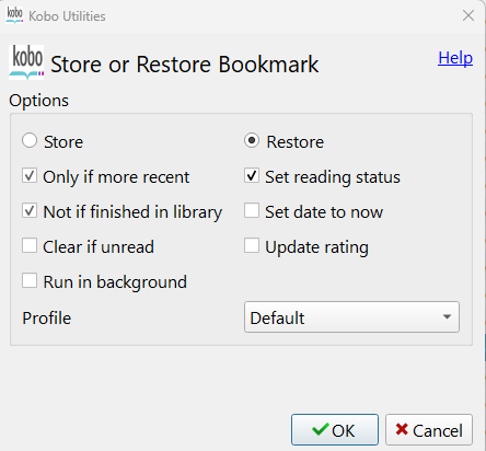

Name:	Screenshot 2024-09-12 022524.png
ID:	210787   Click image for larger version
Name:	Screenshot 2024-09-12 023448.png
ID:	210788   Click image for larger version
Name:	Screenshot 2024-09-12 023517.png
ID:	210789   Click image for larger version
Name:	Screenshot 2024-09-12 024207.png

  6. In the Kobo Utilities menu, select update metadata and click on OK.
I didn't have the columns yet, just created those. I'll give it a go and get back in a bit. But all of this takes a LONG time, because somehow I have to keep rebooting the pc or the ereader every time after disconnecting it, because otherwise it doesn't recognize it and the ereader just reboots.

  15. Run update metadata with same checkboxes as in screenshot #2 (shows 14 books updated)
  16. Go to store/restore current bookmark and run restore with settings in #3
