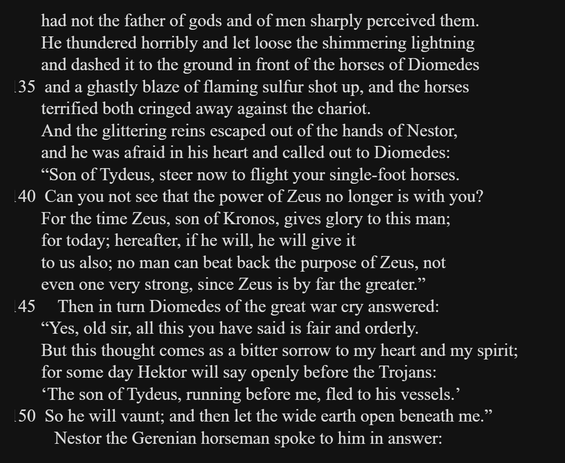

I have a copy of The Iliad, translated by Richmond Lattimore. EPUB format. The text is in verse, and there are line numbers every five lines, as is somewhat common in works like this. The trouble is that once the line numbers reach three digits, they get cut off at the left margin. I've uploaded a screen shot. Those numbers are supposed to be 135, 140, 145, etc. Is there any way I can make this work, or is this book just poorly formatted? Thanks.

It's very poorly formatted. The problem is that you cannot do line numbers line that and not have line breaks in the middle of the paragraph. Also, depending on the text size, the line numbers could be off. So just edit the book to dump the line numbers as they cannot work properly and still be properly formatted. If I needed a large enough font size, the line numbers would be incorrect.

You can probably tweak the CSS of the book to fix it, but cant say how without seeing the actual book.

I cannot see a way to fix it as the line numbers that do not start at the beginning of a paragraph will need to have lines split. That and large enough text will cause the line numbers to be wrong.

You might try making the line number font-size smaller (~85%)
You may need to wrap them in a span, with appropriate CSS callout

I thought of just removing the line numbers, since I don't really care about them, but it looks like it would be one-at-a-time tedious work.
I tried tinkering with the CSS (at which I am NOT an expert) and I kept introducing other problems, so I gave up on that approach.

I am assuming this is just a case of running out of space for the hanging indent.
Years ago, I made my Body font 1.2em and a margin-right:16pt to give room for 3 digits of ADE # on my EZReader

Regex might work to find the numbers (I assumed the start with a period and end with a space)
\.\d+\s
But you probably want to then kill the outdent. for that you need to adjust the CSS for that paragraphs class (Hint: paste that part of the CSS and we can suggest)

Looking at the screen grab from the OP's post, how would you put in 35 without splitting the paragraph?

I really need to see the code view .
I suspect these are individual Paragraphs (and not just a normal wrapped line.)

35 is not the start of a new paragraph. It's in the middle of a paragraph.

I was saying the LINE is the paragraph in this case

Yea, you can see the line numbers are inline with the paragraph text, not a separate paragraph. There is a very slight indent to the text after the number.
