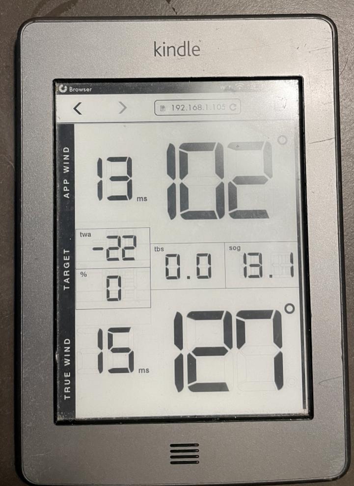

Im really new to the E-ink readers but I built this webb-app which displays data from sensors based on my sailboat (data is gathered from RPI) then I’m showing the data on a Kindle.
I found an old Kindle touch (from 2011!?) which works but the display rendering is kind of ugly/slow. Im currently disabling the screen saver by ”~ds” in the search window, I tested on a Kobo which was a complete different story .
So im wondering if the panel has som input to which model I should get. Any out of the box reader or are there hackable once?

The numbers are just simulated to test.

I HATE seven segment, but that's your problem/taste.
Using a browser has some things going for it and other things going against it.
You have to make it refresh or something.

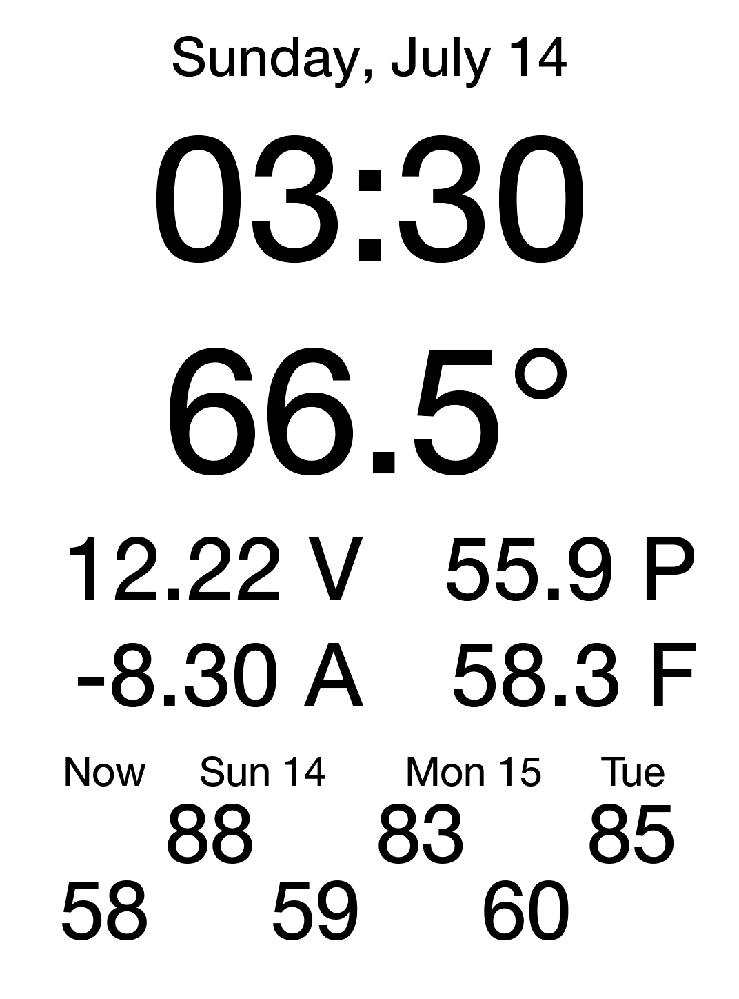

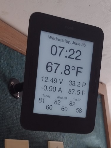

I use a B&N Glow3 with a very simple app that listens on TCP for field IDs and text values.
But, since I hate gratuitous radio communications, I don't use WiFi.
You have to have the thing plugged in anyway, why not use USB?
ADB allows port forwarding. I plug the Glow3 into the RPi.
The RPi has a system daemon spitting out updates over TCP.
In my case, it just updates everything once a minute, but you could update individual fields whenever you wanted.
I've had this a number of years and it used to be a B&N NST without frontlight.
When I updated to the Glow3 I got sick of the USB running out of the bottom of the case.
So I removed the USB connector and wired the USB internally to run down the inside of the mic stand gooseneck.
Now it's much cleaner.
Oh, I got tired of that big "F" and changed it a while ago.
