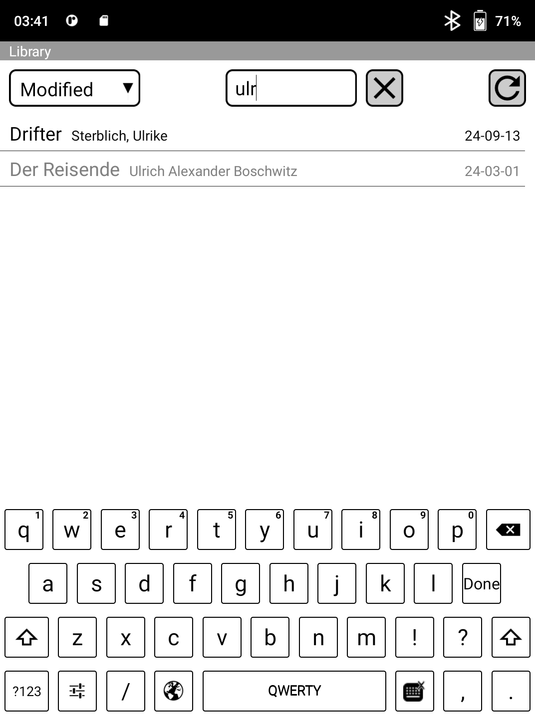

There's no reason you can't use your own library app in parallel with the stock library app. I use my own library app. It displays as a list of single lines. When I'm looking for a book I just have to filter by a few letters to find title or author. Your needs may be different.
