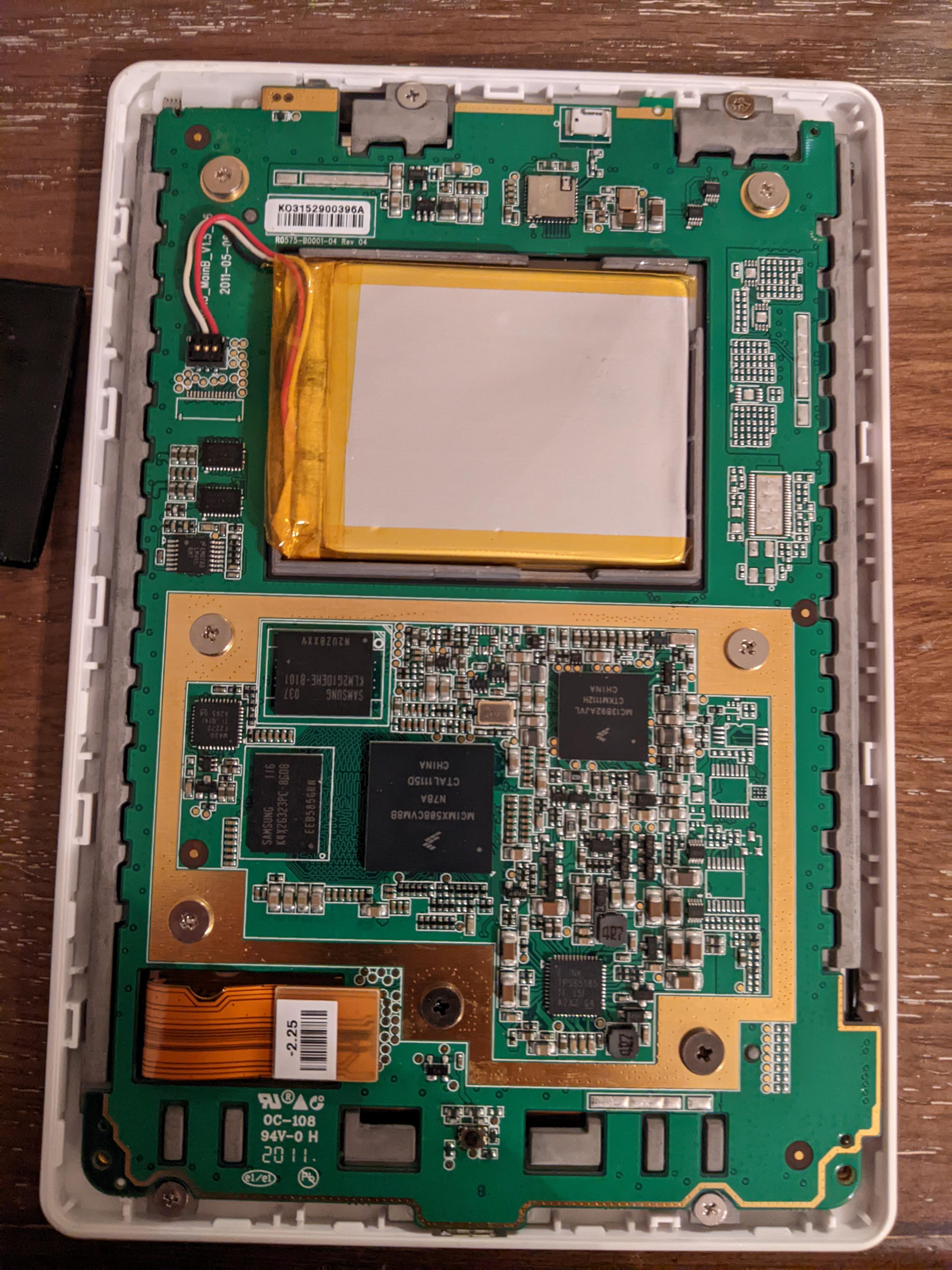

Kobo Mini (& Touch?) batteries on Amazon
For those who live in the U.S. and may need a battery for their Kobo Mini, Amazon is now carrying the one I bought on eBay a couple years ago. (I think it's the same seller.) The advantage is that (with Prime) you can get a quick shipment (in my case one day).
EDIT: The battery in the link (below) is too long. It's supposed to be 59mm long, but it's 63mm instead. That won't fit in the battery cut out for the Kobo Mini. which has a maximum length of 59mm. I've left the battery link in case someone is looking for a battery in a different Kobo that can use a 63mm long battery.
https://www.amazon.com/gp/product/B0...?ie=UTF8&psc=1
REPEAT: The battery linked above will NOT fit in the Kobo Mini. It should, but it's mislabeled. The Kobo Mini needs 59mm or below length, this one is 63mm.
I bought this for battery because I think it will work as a Kobo Touch battery as well. At least on the N905C and probably on a N905B (though I might have to remove part of the battery "frame" on one side for the B version. The N905 uses a three wire battery connection, so I'm guessing it won't work, unless the white wire can be ignored. (It's a shame because the N905 is the one that has a bulging battery that won't hold a charge.)
I figured out something about how these batteries are numbered — probably well known by everyone but me. The six digit number of this battery is 383759. What it means is the 3.8 mm thick, 37 mm wide and 59 mm long. The open space on the N905C is 60 mm long (which means this battery would fit in the 905C) — snug, but would fit. The N905B has the plastic "ridge", which makes it slightly too short for this battery (maybe). But I could probably carefully cut out one side of the "bracket" and make it work. The N905 has the same "bracket" but it also has a three wire connection — so, unfortunately, probably won't work.
The original Kobo Touch battery is 3.8mm thick, 43mm wide and 55mm long.
I guess I'm going to have try to find a three wire battery for the N905 Touch. I'm surprised at the differences in these three models. No SD Card in the original.

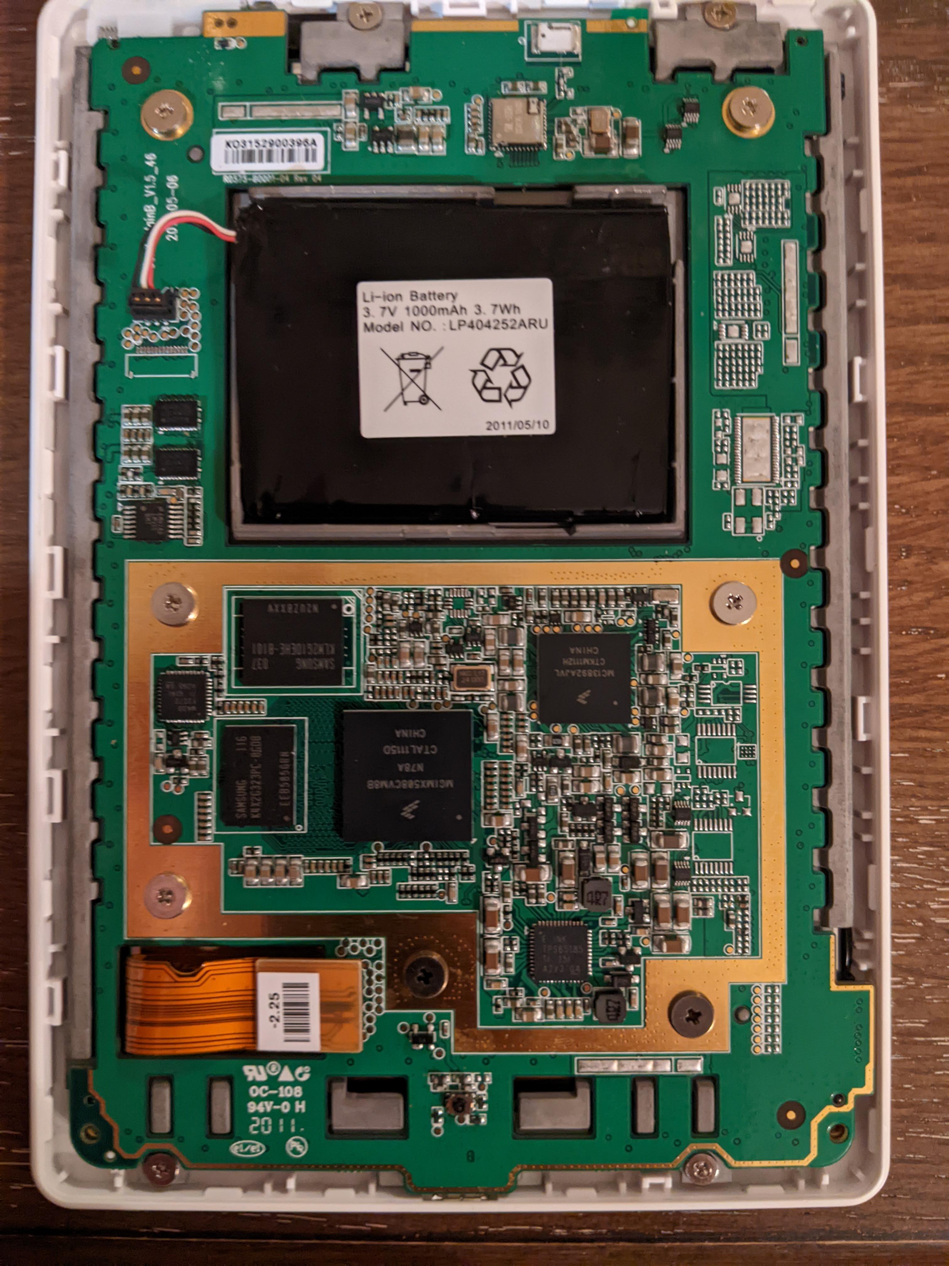

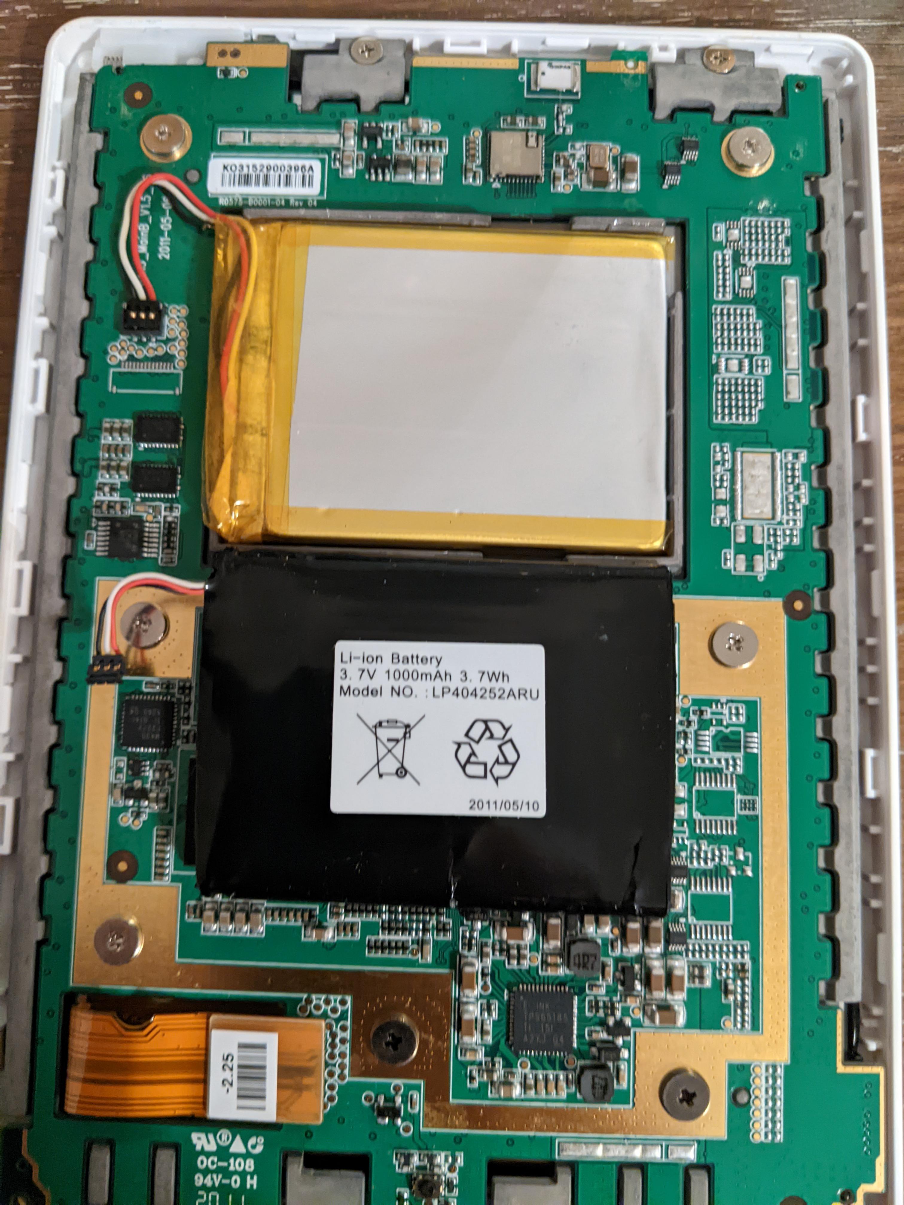

I got the battery in yesterday. Getting the old battery off the "plate" of the older Kobo Mini was not fun. It took very careful prying and some dental floss. Unfortunately I wasn't careful enough with the old battery connector, and it literally crumbled on me. So, for now, I don't have a second usable Kobo Mini. (I'll probably try to use the battery in the N905C Touch, when its battery wears out (still in pretty good shape, as is the N905B battery.)
I broke down and ordered a Kobo Mini battery and a 3 wire Kobo Touch battery at AlliExpress. Both have an expected delivery date of about two months — so summer will be in full swing by the time I get back to them.

One of my batteries from China is supposed to be delivered tomorrow (actually today now) and the other one was in Stockton, CA the day before yesterday. So much quicker shipping than I expected (I was told over 60 days for both). I think the one I'm getting tomorrow is for the original Touch N905. Hopefully the Mini battery (with, supposedly, the right connector) will make it by Friday or Saturday. So two of my ailing Kobos might be back up and running this weekend.

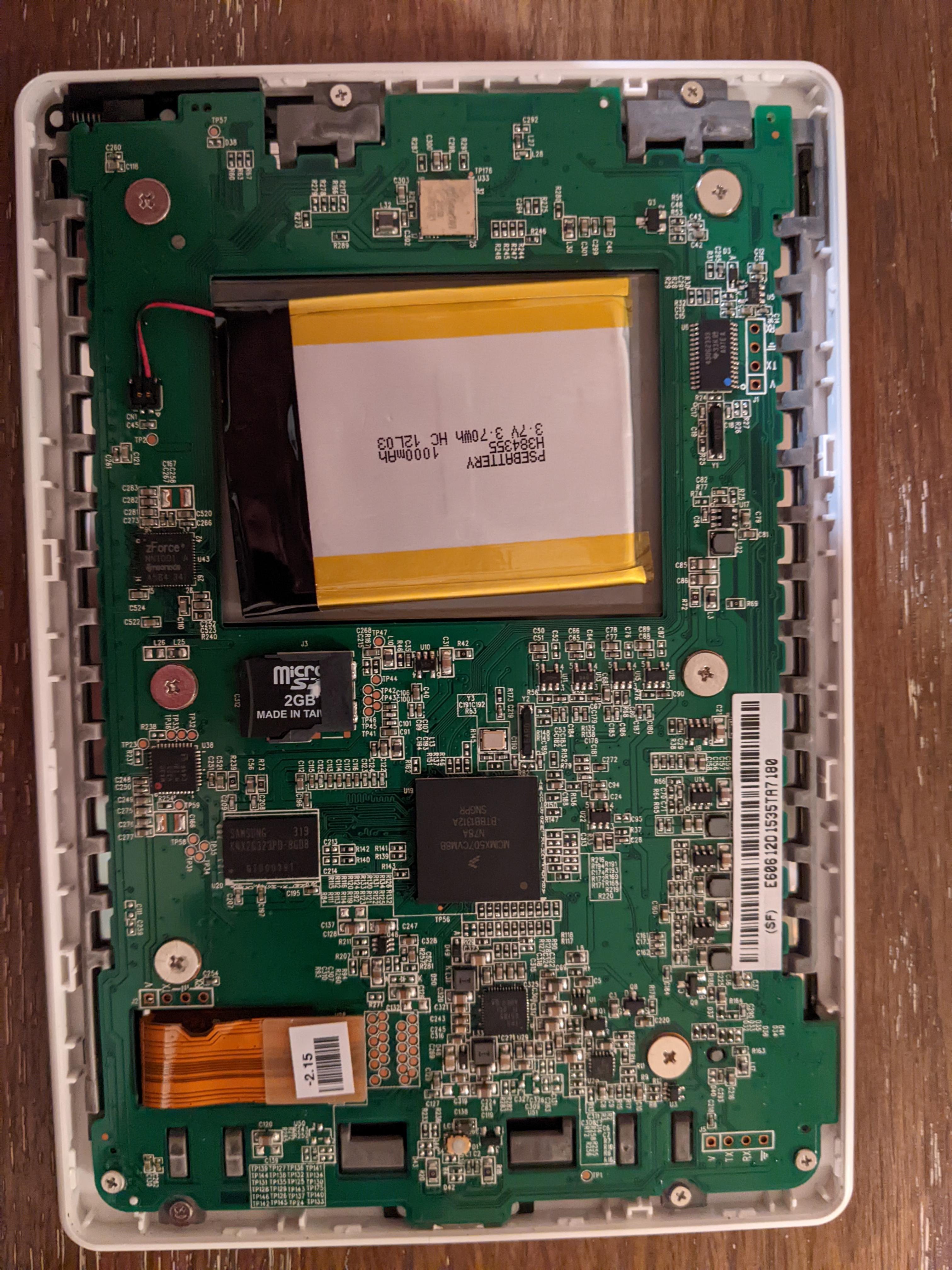

EDIT: The N905 (3 wire) battery arrived today and it's installed. It had the right connector and was pretty much an exact fit. (Had to squeeze the wire side in a little to fit the frame.) I'm charging the battery now, but it looks like it already had a nearly full charge. Now I'll have to test the Touch and see how well the battery holds a charge (and to discharge it completely and recharge it completely, per instructions).
Received the battery in 11 days, which is faster than delivery I sometimes get in the U.S.

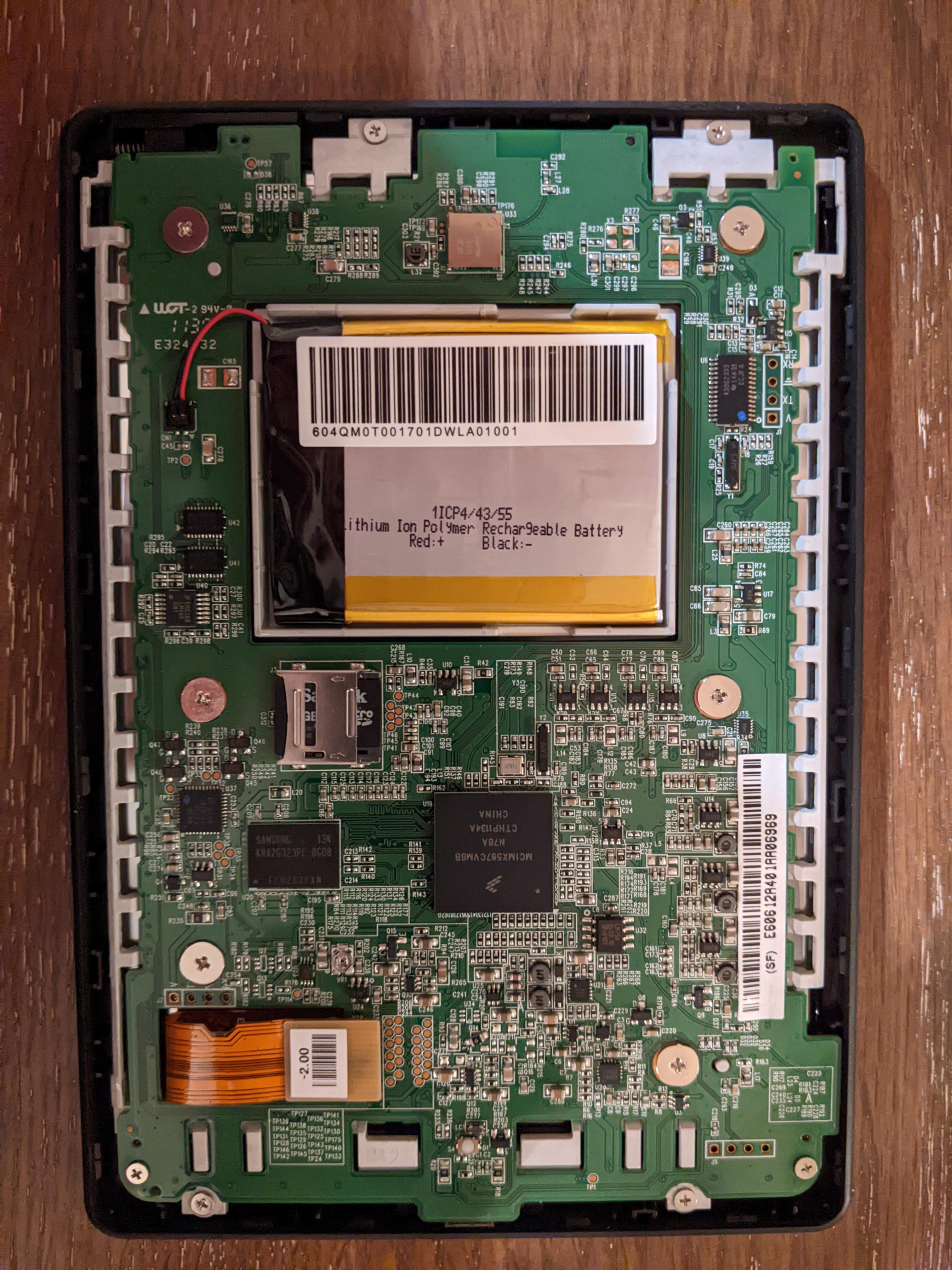

Two pictures below. New battery installed and a comparison between it and the old battery.

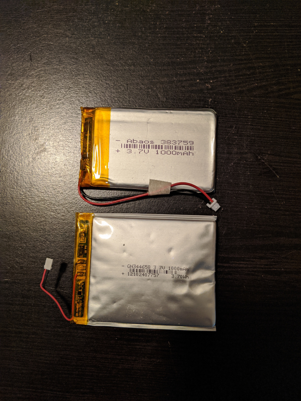

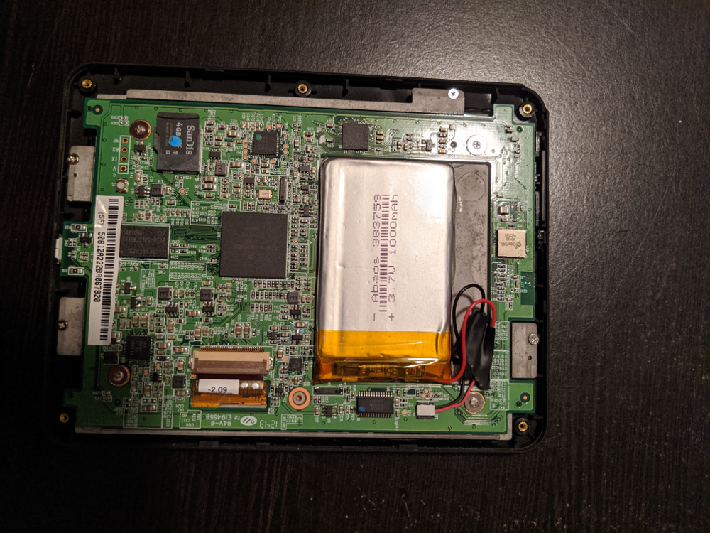

Here's pictures comparing the original Kobo battery with the 384759 one I bought on eBay (and Amazon). They do have different dimensions (as mentioned earlier).
And also a picture of what it looked like installed in my Kobo Mini. Most noticeable is the difference in width.
ID:	208873   Click image for larger version
Old 06-15-2024, 10:19 AM   #15
Cootey
Absentminded Reader
Cootey ought to be getting tired of karma fortunes by now.Cootey ought to be getting tired of karma fortunes by now.Cootey ought to be getting tired of karma fortunes by now.Cootey ought to be getting tired of karma fortunes by now.Cootey ought to be getting tired of karma fortunes by now.Cootey ought to be getting tired of karma fortunes by now.Cootey ought to be getting tired of karma fortunes by now.Cootey ought to be getting tired of karma fortunes by now.Cootey ought to be getting tired of karma fortunes by now.Cootey ought to be getting tired of karma fortunes by now.Cootey ought to be getting tired of karma fortunes by now.
Cootey's Avatar
Posts: 1,345
Karma: 7442365
Join Date: Apr 2017
Device: Kobo Mini, Libra Colour & Elipsa; Kindle Paperwhite 3 & 4; iOS apps
If the specs were the same, I could have worked with that, but the connector you’re showing is not the one I have on the battery here. It’s the wrong connector as far as I can see. I didn’t take it out of its package so that I could return it.
If you ordered it from Amazon and got the right connector then I was just shipped the wrong battery, so your link is probably fine. i’ve been having problems with Amazon shipping the wrong products lately. So I’ll just pick it up from Aliexpress.
