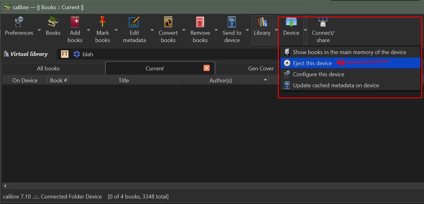

You need to 'eject' the pseudo device folder:
Name:	Screenshot 2024-05-19 165619.jpg

If you have "Connected Folder Device" on the status line, you have connected calibre to a folder (i.e. a 'pseudo device'), you need to eject it - as shown in the screenshot. If you can't see the Device tool, either add it or try the SmartEject plugin.
