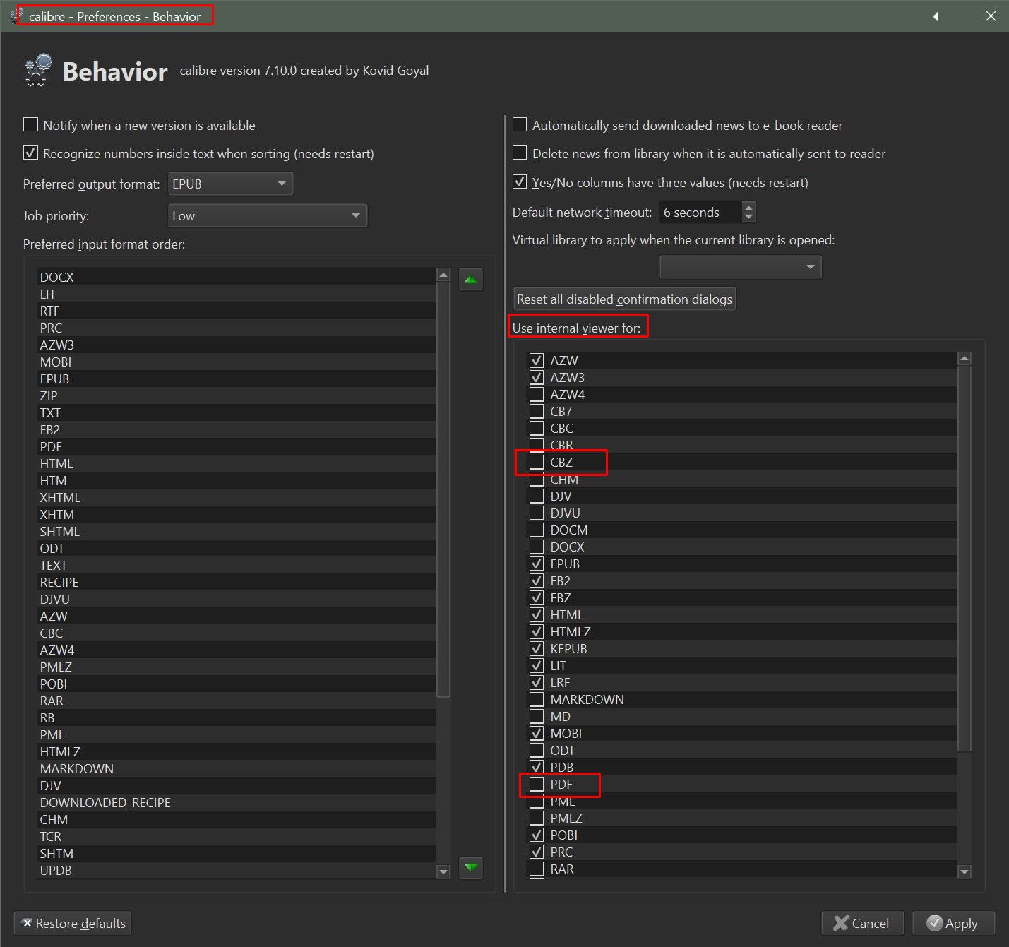

Originally Posted by DaringSteel View Post
- The window that pops up when I open a CBZ file from Calibre is the same one that pops up when I open the file from the Finder window.
See
Name:	Screenshot 2024-05-19 052835.jpg
If a format is not checked calibre will invoke the OS default.
That setting has been there for at least 12 years, maybe forever.
