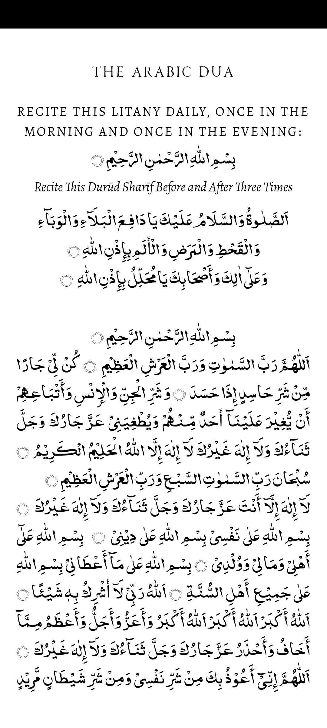

Hi.. I'm new to Calibre. After reading and testing out several options, I made good progress with conversion of a DOC (English and Arabic text) to EPUB, however, the formatting is still not as good as it is on Android.
I have enabled preservation of ligatures, selected the fonts, still no luck.
Attached are screenshots from both: Android and IOS.
Any guidance on this matter will be appreciated.

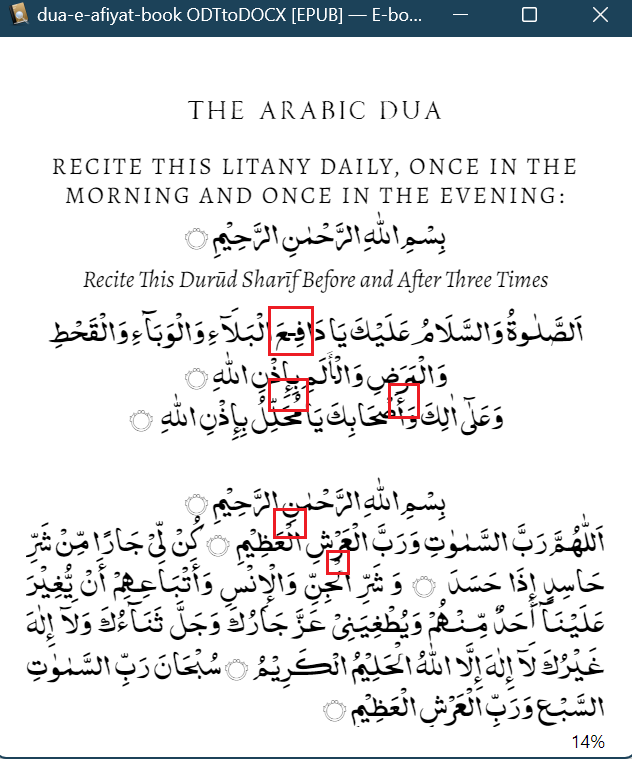

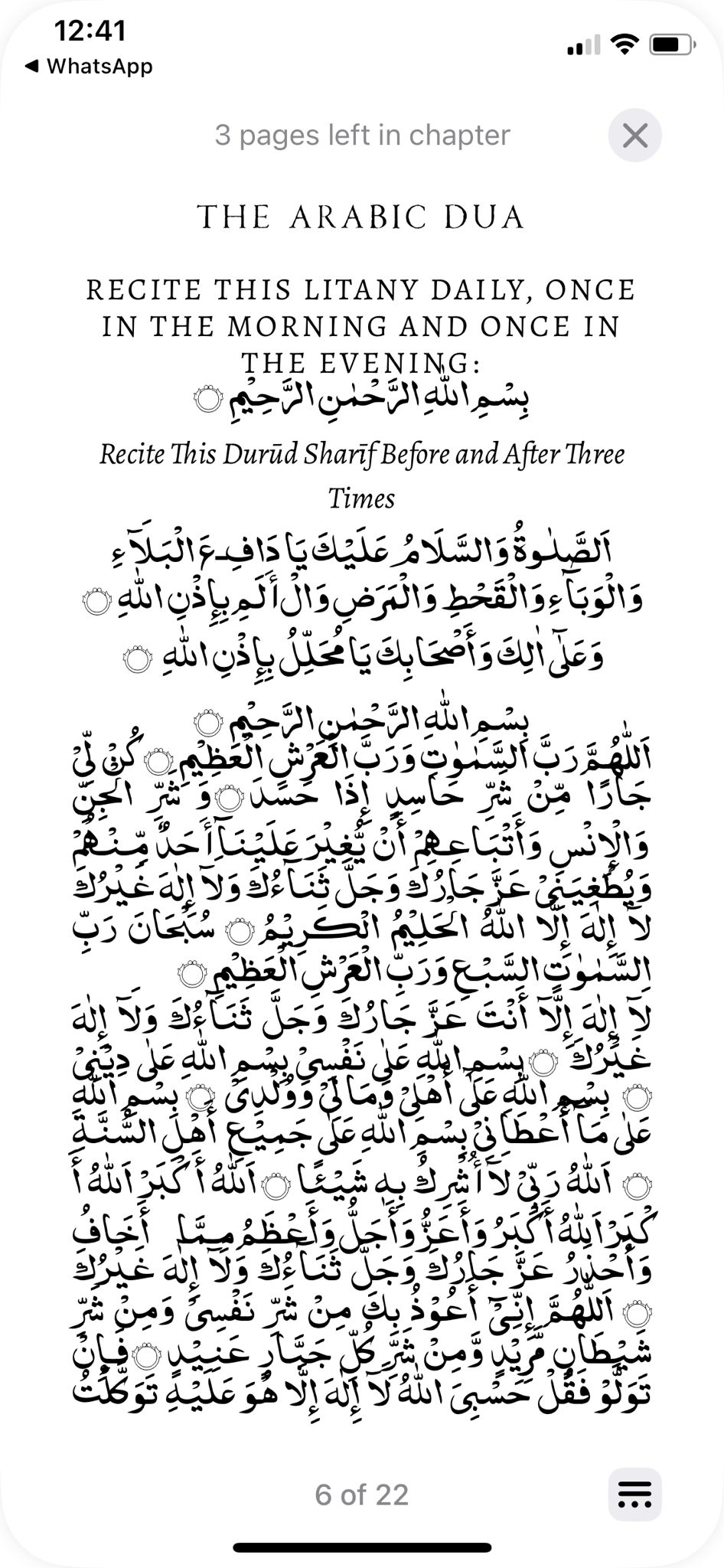

If you take a look at the screenshots I shared from Android and IOS each, the one from Android is spaced evenly and without any breaks in ligatures. Attached a screenshot depicting a couple of these with this reply.
The epub format needs a decent 3rd party app for iOS and Android. Neither have built in epub support. Some apps are not very good.
Using Apple Books in iPhone as opposed to Lithium on Android. The primary audience will be Apple/ Kindle users and most Apple users will use the default Apple Books application.

What is you epub like in Calibre viewer compared to original source?
See attached screenshot. Some of the arabic text and ligatures don't appear right as well in the Calibre E-Book Viewer.

Well, you seem to be doing the right stuff. Certainly Arabic script with its variant median and ending style characters is challenging.
Try a different font.
There are a problems with Books formerly called iBooks and Apple. I ignore it by using Smashwords to redistribute my epub2 to Apple.
Years ago the docx uploads to Amazon KDP lost chapter page breaks and Amazon support told me to upload the same epub2 to KDP as I used for Smashwords after they got a copy and verified it was converting to mobi, azw3 and KFX fine.
So now I upload the same epub2 to Amazon, Smashwords (who redistribute to Kobo, Apple, Barnes & Noble etc) and Google Playstore Playbooks.
The Arabic won't work at all on the four old mobi only Kindles, K1, K2, DX and DXG. The K3, Touch etc all need FW upgrades for azw3 so Arabic works.
The 3.4.3 or later for Arabic
https://www.amazon.com/gp/help/custo...MQC26VQQMM8XSW
Try disabling "Look & Feel > Fonts > Keep ligatures" as that's probably for Latin-Roman etc such as æ Æ fi œ Œ etc.
Try a different Arabic font. Find an ebook (azw3 or epub2) that has embedded font that works OK and use Calibre Editor to see what font it is.
