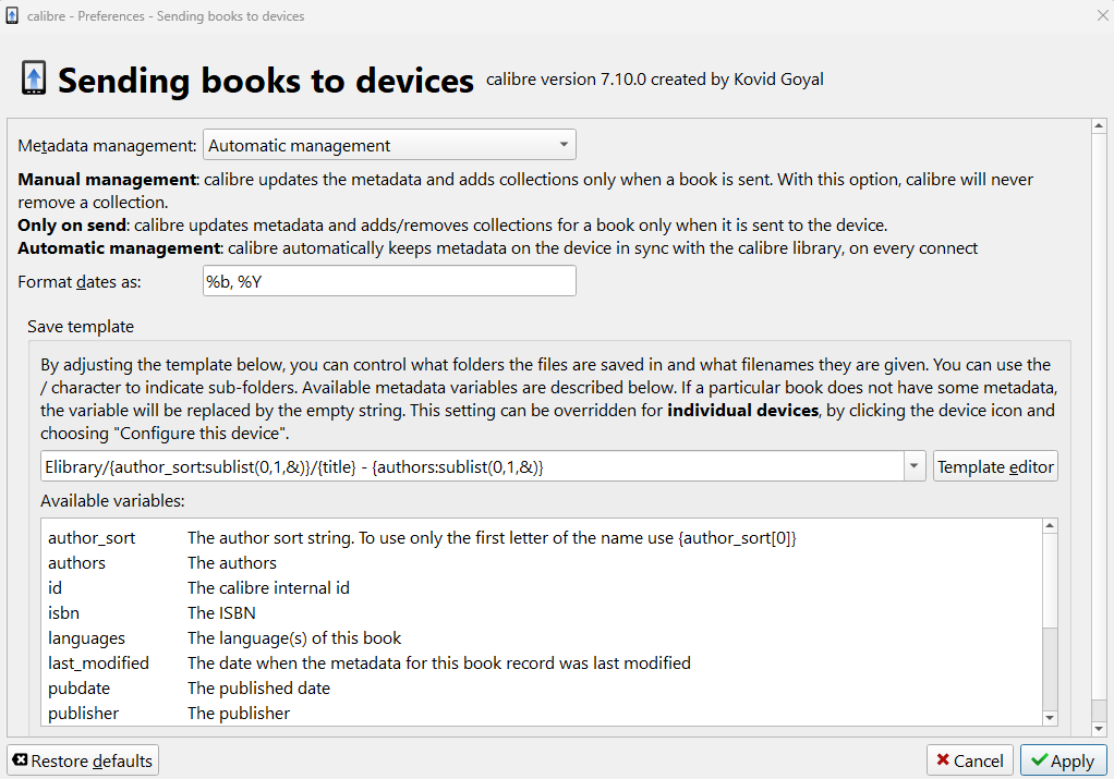

Sirtel, can you give directions on how to turn on the metadata to automatic? Thanks.
Lordblacknail is offline   Reply With Quote
Old 05-05-2024, 12:31 AM   #10
Posts: 48,982
Karma: 174631584
In calibre, Preferences => Sending books to Device => Metadata management.
Name:	Screenshot 2024-05-04 203000.png
